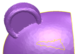

    2. Use one of the options on the Mesh Tools tab > Selection panel to select the area of the mesh that you wish to separate:

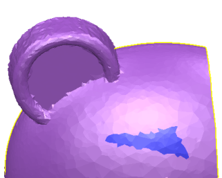

    3. Click Mesh Tools tab > Divide panel > Selection. The mesh is divided into two separate, selected meshes:

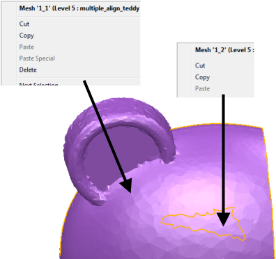

    4. Right-click each area to check that the mesh has been separated:
