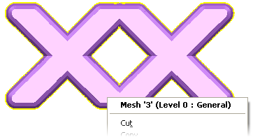

    Use the Divide All option to separate meshes:
    1. Select a mesh:
    2. Click Mesh Tools tab > Divide panel > All.

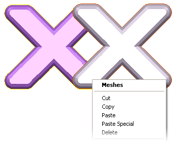

      The mesh is divided to create multiple meshes:
    Note: This option asks for confirmation before dividing a mesh that consists of more than ten unconnected regions.
