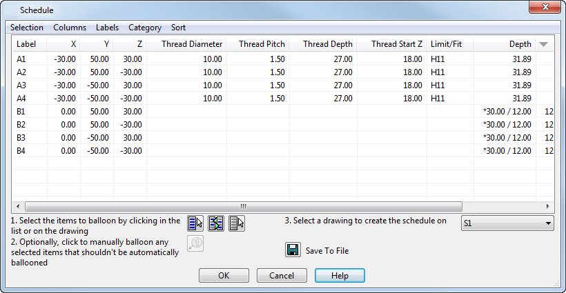

  6. Click Annotation tab > Table panel > Hole to display the Hole schedule dialog:
  7. Select Columns > Thread Details > Thread Top Diameter to select the option.
  8. Click OK.
