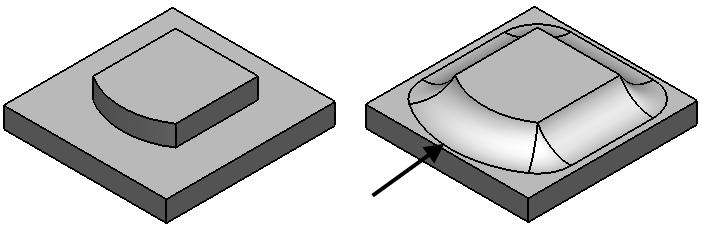

In this model, a fillet of 18 has been created all the way around the top block. The bottom of the fillet that is created is tangential to the bottom block and the top of the fillet touches the edge of the top block at an angle.
