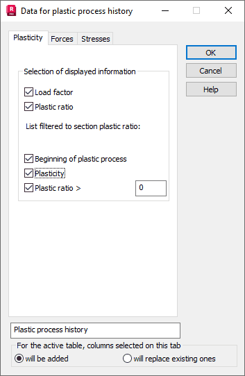

Select the Plasticity tab in the Table Columns dialog to select plasticity quantities for presentation.
The following quantities may be selected for table presentation: load factor and plastic ratio.
The filtering criterion for lists is a state of the section plastic process (value of the plastic ratio).
- Beginning of plastic process - value of the plastic ratio equals 0.0.
- Plasticity - value of the plastic ratio equals 1.0.
- Value of the plastic ratio is always greater than the value defined (a value entered in the edit field has to be greater than zero and less than 1.0).
