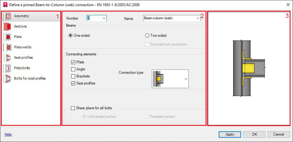

The dialog for generation of a beam-to-column (web) or a beam-to-column (flange) connection has 3 main parts:
- On the left are options for selecting a component used to define a steel connection:
- geometry
- sections
- connecting elements
- stiffening elements(brackets or seat profiles)
- fasteners(bolts or welds).
- In the center, you can define parameters of a selected element of the steel connection.
- On the right is a graphical view of a defined element of the beam-to-column connection.
Note: The number of tabs in this dialog depends on the selected type of a connecting element or stiffening element and the connection type: welded or bolted.
