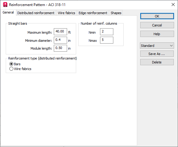

Reinforcement Pattern - General tab (RC wall)
The General tab allows you to define the general parameters concerning reinforcement of an RC wall.

Straight bars
Defines the maximum length of straight bars for reinforcement. An originating condition diameter should be applied.
Module length
Specify a value (module) to which the bar length should be rounded up or down. For example, if a bar is applied at 5.36 m in the first run, the Module Length value 0.10 m would adjust the bar length to 5.40 m.
Reinforcement type (distributed reinforcement)
Defines the type of distributed reinforcement.
  • Bars
  • Wire fabrics
Number of reinforcement columns
Defines the minimal and maximal number of reinforcement columns.

The Save As option allows you to reuse a set of reinforcement pattern parameters. This set is saved to your current user directory. You can reuse this set for the other element in the Reinforcement Pattern dialog or assign it to the selected element (or selected elements of the same type) in the RC Component Inspector.
The Delete option allows you to remove the selected set of reinforcement pattern parameters.
