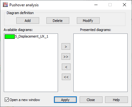

Use this dialog to display analysis results as diagrams, maps, or structure deformations.
Access
  • Click Results Advanced Types Pushover analysis - diagrams.
The Pushover results are available for each of the components separately.
Pushover analysis results are presented as diagrams of a selected quantity in the analysis step (dimensionless time) function.
The dialog in the previous image has the following options:
  • In the Diagram definition field:
    • Add - Activates the dialog for new diagram definition.
    • Modify - Activates the dialog for diagram definition.
    • Delete - Deletes the definition of the diagram currently selected on the list.
  • At the bottom of the dialog are 2 panels: one showing defined diagrams (Available diagrams) and the other, displaying diagrams selected for display (Presented diagrams). Between these panels are the standard buttons for moving the table contents:
    • > - Moves a selected diagram to the right panel.
    • >> - Moves all diagrams to the right panel.
    • < - Deletes a selected diagram from the right panel.
    • << - Deletes all diagrams from the right panel.
  • Open a new window - if selected, a view showing diagrams is opened.
After diagrams are defined and moved to the Presented diagrams field in the Pushover analysis dialog, clicking Apply displays a view with the selected diagrams. The diagrams are presented in the same manner as for time history analysis.
