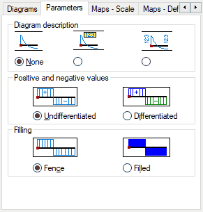

On the Parameters tab in the Stress Analysis - Structure dialog, you can select the manner of presenting stress diagrams.
Specify display parameters:
  • Diagram description - indicates the manner of presenting value descriptions on the diagram
    • None
    • Horizontal
    • Vertical
  • Positive and negative values - specify whether to differentiate colors applied to positive and negative values of the presented quantity
  • Filling - determines the manner of diagram filling
    • Fence
    • Filled
