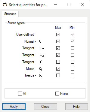

    The Stress Analysis - Structure table displays stress values for selected structure bars. Using the Select quantities for presentation dialog, you select the stress types displayed in the table. To display the dialog, right-click in the table, and click Table Columns.
    You can select minimal and maximal values for all available stress types and for user-defined stresses.
