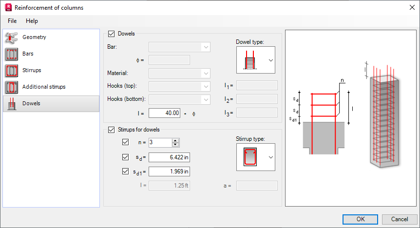

Parameters of dowel bars:
- Dowel bar type:
- Diameter and material of bars
- Hooks (in the top and base of the column)
- Length.
Stirrups for dowels
The option is turned off by default.
You can define stirrups for all dowel bar types except
Parameters for stirrups:
- Stirrup type (by default, the same as selected on the Stirrups tab)
- Number of stirrups n (the minimum number is 1)
- Spacing between stirrups sd
- Distance from the top of the column to first stirrup from the bottom sd1
- Length of a dowel to the top of the column l (it is defined in the Dowels field)
- Cover value a.
Stirrups are distributed from the top of dowel bars with the spacing sd; the first stirrup from the bottom is spaced sd1 from the top of the column. Distribution is defined by manipulating with the parameters: n, sd and sd1. They are either defined by the user in the fields next to the corresponding check boxes or calculated automatically (when check boxes are deselected). Below you can view possible combinations of parameters defining the distribution.
- Define the number of stirrups n; stirrups are distributed evenly; sd and sd1 are calculated automatically.
- Define the number of stirrups n and spacing sd; sd1 is calculated automatically.
- Define the number of stirrups (distributed evenly) n and spacing sd 1; sd is calculated automatically.
- Define the number of stirrups n, spacing sd and sd1; (n-1) stirrups are spaced sd from the top of the dowel; the first stirrup from the bottom of the dowel is spaced sd1 from the top of the column.
- Define the spacing sd and sd1; the number of stirrups n is calculated automatically.
- Define the spacing sd; the number of stirrups n and sd1 are calculated automatically.
