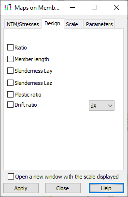

Click Design tab in the Maps on members dialog, to display the following quantities:
- Ratio
- Member length
- Slenderness Lay
- Slenderness Laz
- Plastic ratio - If selected, it displays the percentage of fibers in the member cross section that have undergone plastification.
- Drift ratio - If selected, it displays the ratio of drift to member length (dr/h). The drift is a difference of the member ends displacements. For details see: Member Displacement.
- Forces - RC T-beam considered with the slab - If any of the options is selected, it displays forces or a moment reduced to the center of gravity of an RC beam that is integral with the RC slab (see: Calculations of RC beams with the slab considered).
