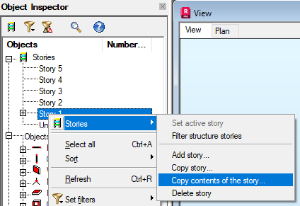

  1. Go to the View tab. All of the elements that you have created can be copied to the other stories.
  2. In the Object Inspector, right-click on Story 1 and select Stories > Copy contents of the story… as shown below.
    Note: If you did not have additional Stories in the project, you could use Copy story… and have the software create the story and copy the contents.

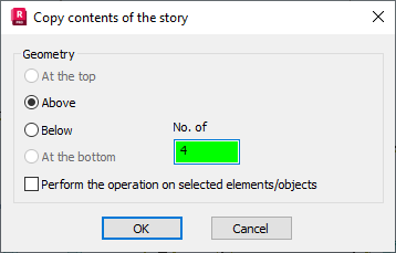

  3. In the Copy contents of a story dialog box, set the Geometry to Above and the No. of repetitions to 4 as shown below.

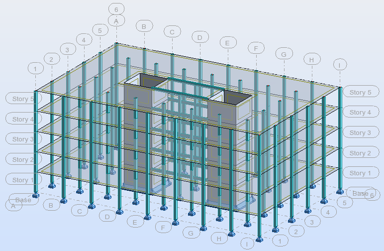

  4. Click OK.The contents of Story 1 are copied to the other stories as shown below.
