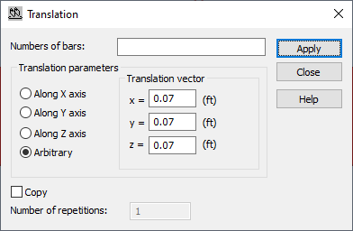

Select Reinforcement > Translate to perform translation of selected reinforcing bars of an RC structure. This option is available in the menu of the modules used for designing RC structure elements (RC Beam, RC Columns, Foundations, Deep Beams).
Select the reinforcing bars that are to be translated.
Determine the parameters of the operation of translation.
  • Translation direction (along X axis, along Y axis, along Z axis, arbitrary)
  • Translation vector
The Translation dialog allows you to use the copy option. If selected, the Number of repetitions option becomes available.
