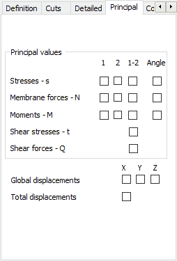

    Select the Principal tab in the Panel cuts dialog to display the following options.
    The following quantities may be selected for presentation.
    • Stresses: s1, s2 and s12 as well as the angle
    • Membrane forces: N1, N2 and N12 as well as the angle
    • Moments: M1, M2, M12 as well as the angle
    • Shear stresses t12
    • Shear forces Q12.
