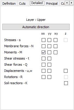

Select the Detailed tab in the Panel cuts dialog to display the following options.
The following quantities may be selected for presentation.
  • Stresses: sxx, syy, sxy, sz
  • Membrane forces: Nxx, Nyy, Nxy
  • Moments: Mxx, Myy, Mxy
  • Shear stresses: txx and tyy
  • Shear forces: Qxx and Qyy
  • Displacements: uxx, uyy and w
  • Rotations: Rxx, Ryy and Rz
  • Soil reactions K.
The top of the dialog presents information about the layer for which the calculation results will be presented. The button below opens the Selection of Direction dialog which defines the main direction of a coordinate system (x axis direction) used while displaying planar finite element results.
