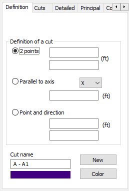

Diagrams are drawn in arbitrary user defined cuts. For two-dimensional structures, the cut is made along a straight line or a segment located in the plane in which the structure has been defined. For shells, the cut is defined by an arbitrary plane in 3D space. You can define several cut diagrams for one structure. To create a diagram of any of the available quantities of internal forces, stresses and local displacements in finite elements, it is necessary to define the line of the cut and indicate which of the available quantities is to be displayed in the diagram.
You can define more than one plane (straight line) when determining the cut. Diagrams may be drawn simultaneously for several cuts. Defining a new cut adds it to the previously defined cuts. Diagrams may be drawn as tangent or normal in respect to the plane of the cut. You can also use smoothing for element-to-element transitions.

To display a diagram of any quantity on screen, perform the following.
- Define cuts through a plate or shell structure.
- Select the quantity to be presented in a diagram.
- Determine the diagram parameters.
- Click OK.
