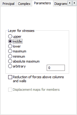

    Select the Parameters tab in the Panel cuts dialog to select a layer parallel to the central plane of a planar structure for which the calculation results will be presented.
    You can define the places for which planar finite element results are displayed. These can be upper, middle, lower, maximum, minimum, absolute minimum or arbitrary (its coordinates are presented in the field located by the command).
