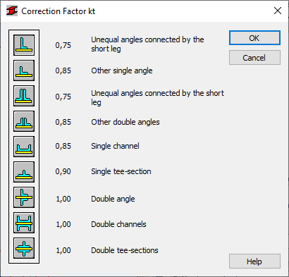

Correction Factor kt (AS 4100)
Use this option to define a value of the correction factor kt. This factor is taken into account when calculating tensile resistances of a member, as specified in Section 7.2 of the code. You can select one of the options in this dialog which coincide with the factor values in table 7.3.2 of the code.
