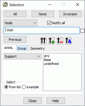

The Selection dialog is used to pick objects from the structure. It is accessed by selecting Edit > Select. It may also be activated for individual objects by clicking the following under the menu: node selection, bar selection, load case selection, and vibration mode. You can also select View > Filter while in the table.
Options are similar for the node, bar, and load case object types. Other appear in the Selection dialog if Modes are selected.
To perform a selection, do the following:
  1. Indicate the object (node, bar, panel, solid, load case, mode, or others).
  2. Enter the corresponding numbers of the selected objects, or use the options found in the lower portion of the dialog.
Note: If Hide nodes, Panel contours, Panel interior, Contour components, or FE mesh are selected, then while selecting structure components on the screen, structure elements are not highlighted in the Object Selection dialog. If these structure elements are selected by window, parallelogram, circle, or others (in Select Special), they are not highlighted on the screen, but are selected.
The bottom of the Selection dialog depends on the object selected. Performance of the options available here is described based on node selection.

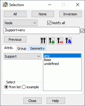

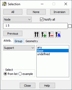

Nodes may be chosen using the node attributes (object) support, finite element, panel, solid, bar, compatibility, rigid link and emitter. They are selected in the right part of the dialog.
Selecting one of the types and clicking adds all support nodes (regardless of the support kind) to the selected nodes.
A checkbox for determining the definition of selection mode is found to the right of the list of selected nodes. If deselected, the field of node selection will display node numbers corresponding to the nodes where the support is applied.
If selected, the field of node selection will display Support = any.
Note: Bars, objects and panels may be selected using the object name.
