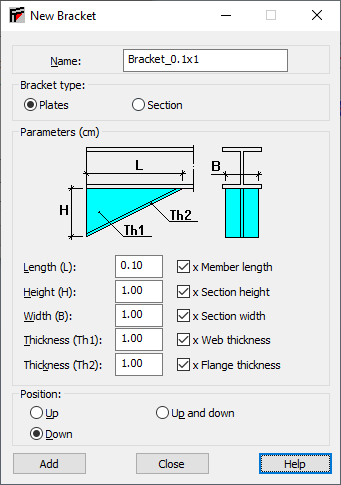

Clicking in the Bracket dialog opens the dialog, where you can define a new bracket type.
You can select the following brackets:
  • Plates of determined dimensions
  • An appropriately cut section for a given member.
When you select the type of bracket, specify the following parameters:
  • Bracket dimensions (absolute or relative values, with respect to section dimensions),
  • Bracket type (upper, lower, or at both sides).
A bracket defined this way can be saved under a label you choose. Later, you can use this bracket many times in a structure. Brackets of a member are introduced separately for each member end.
Note: A bracket defined through relative values is automatically adjusted to the member and the section. Therefore changing the section during design, changes the bracket dimensions that depend on the section dimensions.
