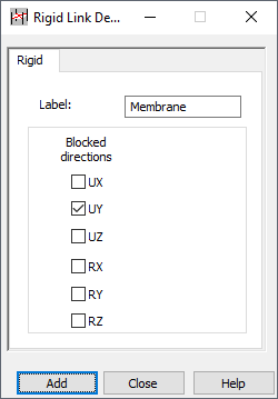

Use the Rigid Link Definition dialog to define new rigid links in the structure.

Rigid
To define a new rigid link, assign a Label and select the blocked directions in the rigid link:
  • UX
  • UY
  • UZ
  • RX
  • RY
  • RZ
Note: Unblocked degrees of freedom apply only to the slave nodes of a rigid link.
Clicking Add adds the new rigid link to the list of active links.
Important: The blocked directions are defined in the global coordinate system.
