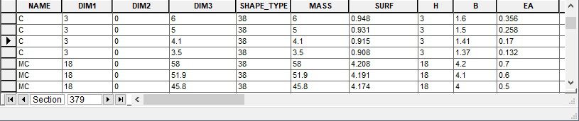

Table Containing Section Data
All sections located in the currently selected section database display in the lower part of the viewer. The following data is presented for each section.
  • The section name.
  • Basic section dimensions (dim1, dim2, dim3). Depending on the section, one or more of these dimensions is filled. Empty dimensions are marked 0.
  • Section Shape Type.
  • All available dimensions and geometric properties of the section (dimensions d_1, d_2... angle a_1, a_2 are additional geometric section parameters).
  • The Section symbol. This contains a full description of section geometry when the profile is not standard.
The final four table columns provide the following information.
Thin-walled. Specifies a thin walled section
Material. Specifies that a material has been defined together with the section.
Material description. A complete description of materials in a section
Points. A description of the characteristic points of a section.
