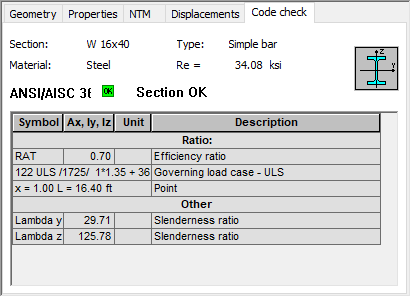

Click the Code Check tab in the Member Properties dialog for an RC member (after calculation of reinforcement theoretical (required) area) to display the following:
The following information, that you cannot change, displays:
  • Section name, such as, Section: B20x40
  • Material name, such as, CONCRETE
  • Type of RC element, such as, RC Beam and RC Column
  • Name of calculation parameters, such as, standard
  • Calculation status and RC structure design code, such as, PN, and BAEL, information about the calculation status: OK, Out-of-date, or None.
