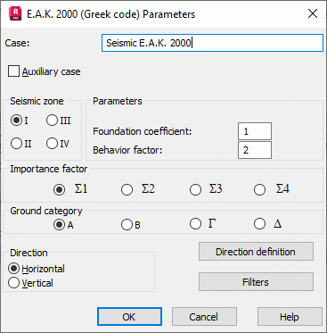

Parameters of a structure seismic analysis depend on a seismic code used during calculations of a structure influenced by seismic impact. Select Greek seismic code E.A.K. 2000 or E.A.K 2000/2003 in the New Case Definition dialog or click Parameters in the Analysis Type dialog.
To complete the seismic analysis according to the rules given in a code, define the following parameters:
  • Seismic case name
  • Seismic zone, structure importance, ground category and direction
  • Values of two Parameters:
    • Foundation coefficient
    • Behavior coefficient.
In the lower part of the dialog, the Direction definition and Filters buttons are located.
The details concerning this structure analysis method can be found in the mentioned code.
