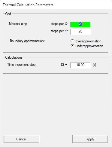

Click Calculation options in the fire resistance calculator menu to open the Thermal Calculations Parameters dialog.
The following options are available.
  • Parameters of a calculation grid created in the cross-section of an RC element.
    • Division of the cross section area in the X and Y coordinates (specify a number of edge divisions along the axes X and Y)

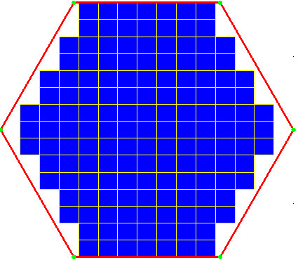

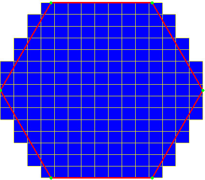

    • Approximation of the cross-sectional contour.
      • Underapproximation.
      • Overapproximation.
  • Time increment step is a value of the time step in thermal calculations.
