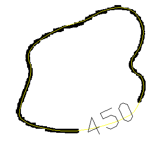

You can use the contour follower to vectorize a contour and the vtext command to convert the text label associated with it.

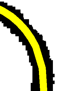

Contour follower vectorizes contours Magnified view of new vector VText vectorizes text
