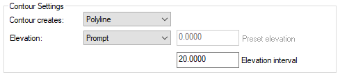

On the ribbon, click Raster Tools tab Vectorize & Recognize Text panel Dialog box launcher () to open the Raster Design Options dialog box. Click the VTools General tab. In the Removal Method area, click Rub.
Click the VTools Follower tab. In the Contour Settings area, select Contour Creates Polyline and set Elevation Interval to 20. Click OK.
These settings ensure that when you trace a raster contour, it is replaced by a vector polyline and the original raster is erased.
