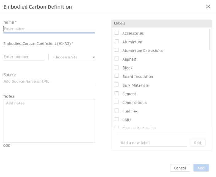

EC definition Name: Embodied Carbon definitions can be a specific product from a manufacturer, a type of product, or an aggregation of multiple products.
Notes: Use Notes to convey assumptions made for the respective Embodied Carbon definition.
Source: Use the source column to organize your data in the list. User-defined Embodied Carbon definitions can display web links.
Labels: Labels are used as containers of data that help you better organize and categorize your EC definitions.
To create and edit a definition
- In the construction summary, expand the Embodied Carbon definition value to display the search window.
- Click Advanced Search.
- From the top of the Advanced Search Window, click Add Definition.
- Inspect the results and the embodied carbon definition, assign an embodied carbon coefficient, and assign labels to the definition.
- Click Add.
