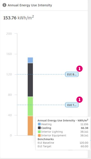

Visually see the performance of metric against a set benchmark.
When added to a performance metric, a benchmark
serves as a visual reference point. It allows you to compare the measured performance of the metric against the established benchmark.
Metric with two benchmarks added

- When you add a bar chart Metric card to a dashboard, the benchmarks will appear on the metric.
