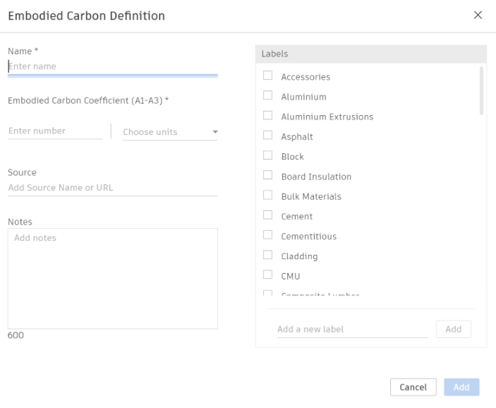

EC definition Name: Embodied Carbon definitions can be a specific product from a manufacturer, a type of product, or an aggregation of multiple products.
Notes: Use Notes to convey assumptions made for the respective Embodied Carbon definition.
Source: Use the source column to organize your data in the list. User-defined Embodied Carbon definitions can display web links.
Labels: Labels are used as containers of data that help you better organize and categorize your EC definitions.

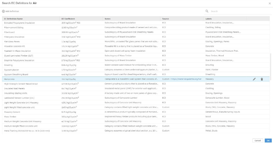

  1. In the construction summary, expand the Embodied Carbon definition value to display the search window.
  2. Click Advanced Search.
  3. From the top of the Advanced Search Window, click Add Definition.
  4. Inspect the results and the embodied carbon definition, assign an embodied carbon coefficient, and assign labels to the definition.
  5. Click Add.
