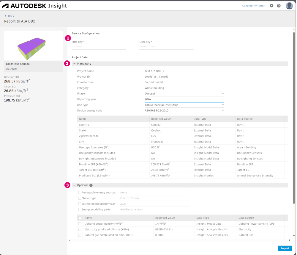

  1. From the App Home page, select 'Report to AIA DDx.'
  2. Enter your API key (your firm key) and User key (your user ID) 1.
  3. Review and collect mandatory 2 and optional data 3 to be reported. This information is derived from the Insight model, metrics, and third-party APIs. It includes information such as the following:
  • Project Name
  • Location
  • Predicted EUI
  • Baseline EUI
  • Lighting Power Density (LPD)
  • Window to wall Ratio (WWR)
Report

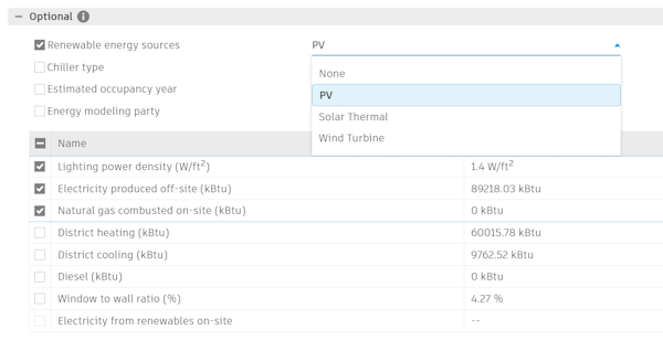

  1. In the Optional section, certain fields are editable, make adjustments as needed.
Optional
Note: You can right click, to search the optional data you would like to adjust.
  1. Once the edits are complete, click 'Report' to submit to AIA DDx.
  2. You will receive a confirmation message once the submission is complete.
