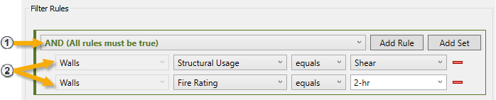

Rules and rule sets
A rule-based filter contains one or more rule sets . Each rule set contains one or more rules and/or nested rule sets.
There is no limit to the number of rules and rule sets you can define.
Each rule set uses the AND condition or the OR condition:
  • AND: All of the rules and rule sets nested within this set must evaluate as true.
  • OR: One or more of the rules or rule sets nested within this set must evaluate as true.
Plan filter rules carefully using AND and OR conditions and nesting to make sure you get the desired result. See Examples of Rule-Based Filters.

When creating a filter, you first select one or more categories. Then you create rule sets. For each rule in a rule set, specify a parameter, an operator, and a value.
The parameters that are available for creating rules depend on the categories that you select for the filter. Before creating a filter, consider carefully what you are trying to accomplish, and how you can best identify those elements. Determine the categories to use for the filter.
For example, to create a filter that identifies 2-hour fire-rated doors, select the Doors category. To create a filter that identifies 2-hour fire-rated doors and walls, select the Doors and Walls categories.
When you select multiple categories for a filter, you must specify the category of each rule before you can select the parameter to use for the rule.

When entering a value for the rule, you can do one of the following:
  • Select a value from the drop-down list, which shows values from elements in the current model.
  • Enter a value. For numeric values, you don't need to specify the unit. Text values are case-insensitive.
If you want to select multiple values for a parameter, add one rule for each value. Nest these rules under a rule set with an OR condition.
