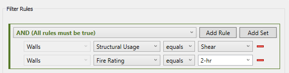

Simple AND condition
When a rule set uses the AND condition, all of its rules and nested rule sets must be true.
Consider the following example:
  • You want to identify all shear walls in the model that have a 2-hour fire rating.
  • For the category Walls, this filter reflects the following formula:
    Structural Usage = "Shear" AND Fire Rating = "2-hr"

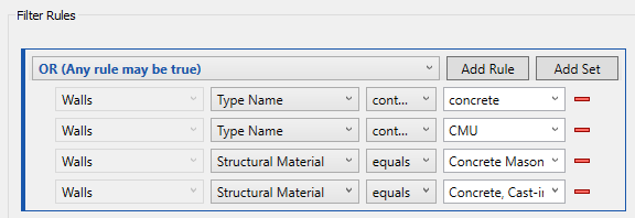

Simple OR condition
When a rule set uses the OR condition, one or more of its rules or nested rule sets must be true.
If you want to select multiple values for a parameter, add one rule for each value. Nest these rules under a rule set with an OR condition.
  • You want to identify all walls in the model that are made of concrete.
  • In your model, the names of wall types may contain the words "concrete" or "CMU", or their material is indicated using the Structural Material parameter.
    Type Name contains "concrete"
    OR Type Name contains "CMU"
    OR Structural Material = "Concrete Masonry Units"
    OR Structural Material = "Concrete, Cast-in-Place gray"

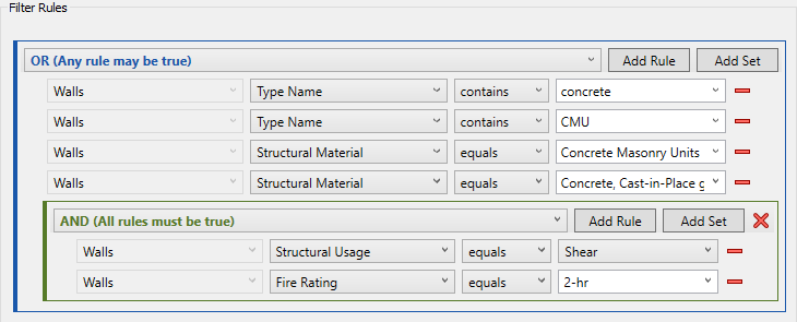

OR with a nested AND -- Does not achieve the goal
If you create the following filter, using an AND rule set nested within an OR rule set, you will not achieve the goal.
  • For the category Walls, that filter reflects the following formula:
    OR (Structural Usage = "Shear" AND Fire Rating = "2-hr")
  • This filter does not achieve the desired result. It identifies walls that are concrete OR walls made of any material that are shear and have a 2-hour fire rating.

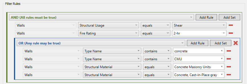

AND with a nested OR - Achieves the goal
In this case, to identify all shear walls in the model that are made of concrete and that have a 2-hour fire rating, you must start with the AND rule set, and nest an OR rule set within it, as follows:
    AND (Type Name contains "concrete" OR Type Name contains "CMU" OR Structural Material = "Concrete Masonry Units" OR Structural Material = "Concrete, Cast-in-Place gray")
These examples demonstrate why it is critical to think carefully about what you are trying to accomplish, and why it is so important to plan the filters and test them thoroughly.
