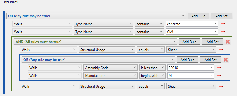

Consider the following example:
These filter rules reflect the following formula:
- Type Name contains "concrete"
OR Type Name contains "CMU"
OR (Structural Usage = "Shear" AND (Assembly Code < B2010 OR Manufacturer begins with M))
