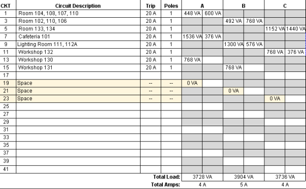

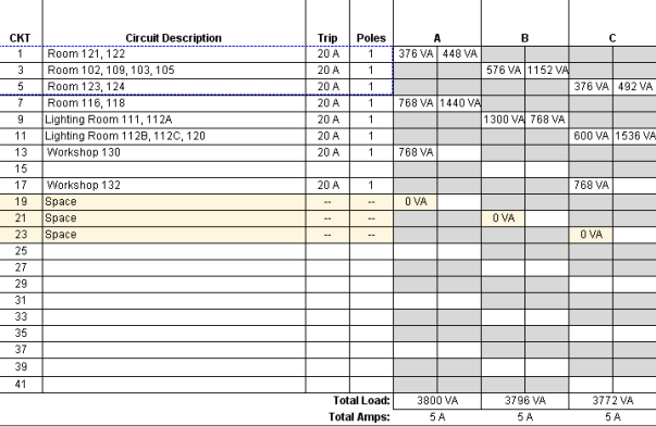

Rebalance loads on a panel schedule
Use this procedure to redistribute the loads on a panel schedule so that the loads on each phase are as equal as possible. You can also rebalance only a subset of loads by locking the slots that you want to exclude.
  1. Open a panel schedule.
  2. Click Modify Panel Schedule tabLoads panel Rebalance Loads.
    The loads are redistributed on each phase.
    Note: To rebalance a subset of circuits, you can lock the circuits that you want to remain in their current positions.
