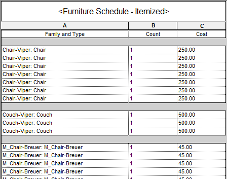

Itemize Every Instance
To list every instance of the family and type in a schedule, on the Sorting/Grouping tab of the Schedule Properties dialog, use the following settings:
- Sort by = Family and Type (Ascending, Blank line)
- Itemize every instance = on

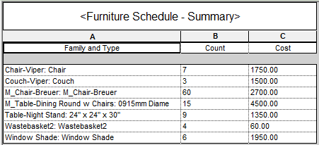

Summary Schedule
To provide a summary of the families and types in a schedule (eliminating separate lines for each item), on the Sorting/Grouping tab of the Schedule Properties dialog, use the following settings:
- Itemize every instance = off
