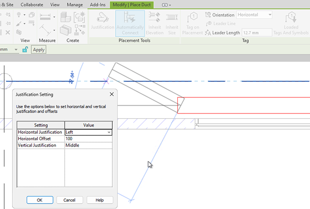

Use the following settings to align duct.
This dialog is accessed by clicking the
Justification Settings while the Duct tool is selected. You can specify the following justification layout options.
Horizontal Justification: aligns the edges of duct sections horizontally, using the Center, Left, or Right side of the duct as a reference.
Horizontal Offset: specifies an offset between where you click in the drawing area and where the duct is drawn. This option is helpful when placing ductwork at a fixed distance from another component in a view.

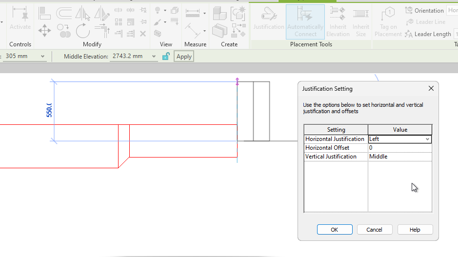

- Vertical Justification: aligns the edges of duct sections vertically, using the Middle, Bottom, or Top of the duct as a reference.
