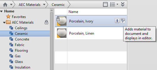

  1. Select the material in one of the following places in the Material Browser:
    • In the project materials list, click a material.
    • In the library materials list, click a material, and then click the Add-Edit button. This button adds the material from the library to the project materials list.
    The Material Editor panel displays the assets of the selected material in edit mode.
