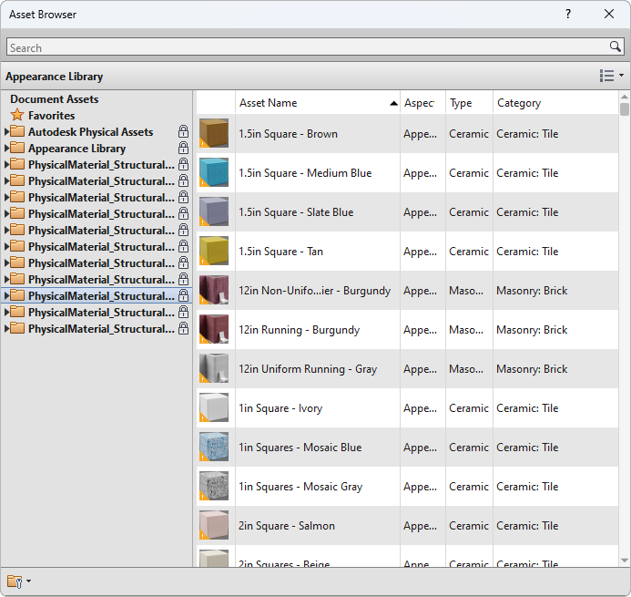

- To select an asset for editing, in the Asset Editor, click
(Opens/Closes Asset Browser).
The Asset Browser opens.
In the asset list, the
icon indicates legacy appearance assets. For details, see
About Appearance Assets.
Tip: Use new appearance assets (without the
icon) for materials. This practice ensures that views and rendered images use the most up-to-date, highest quality representations of materials.
- Right-click the asset to edit, and click Add to Editor.
