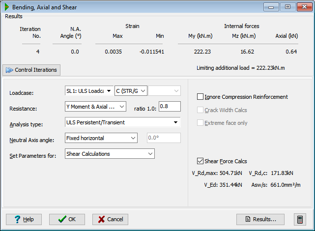

In the example above, the parameters in the first command are equivalent to running the analysis with the settings shown in the following dialog:
Bending, Axial and Shear
The second command creates the data file as a project SST model file.
