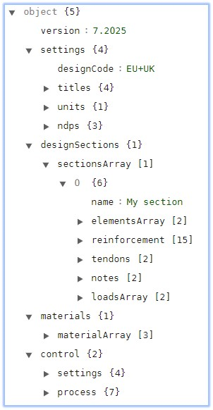

Here is a JSON example, showing the higher-level objects.
Model Data Outline
It contains 5 main blocks.
  • settings This object contains parameters relating to the Design Code, Titles, Units, and for Eurocodes only, the Nationally Determined Parameters.
  • designSections This object contains parameters relating to one or more Design Sections.
  • designBeams This object contains parameters relating to one or more Design Beams.
  • materials This object contains parameters relating to the material definitions (concrete, steel, reinforcement, prestress, etc.).
  • control This object controls automation and will be discussed below.
The example above defines a single section made up of 2 elements. There is a block which details the reinforcement and tendon location, an optional notes object and an array containing 2 load cases.

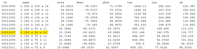

To define a specific component, such as a European unequal angle 150 x 90 x 10, you can refer to the document "EuropeanSectionsSteel.pdf" to find the corresponding identifier (id) for that particular component.
Standard library Unequal angle
The JSON to describe this shape is:
  "shape" : "STANDARD_STEEL",
  "id": 30311007,
  "hookRef": 1,
  "hookY": 0,
  "hookZ": 0,
  "propertyRef": "MP1"
In this JSON structure, the shape field indicates that it is a standard steel component. The id field represents the identifier for the specific shape, which in this case is 30311007. The hookRef, hookY, and hookZ fields define the hook reference and its Y and Z coordinates, respectively. The propertyRef field refers to the material property identifier, which in this case is MP1.
