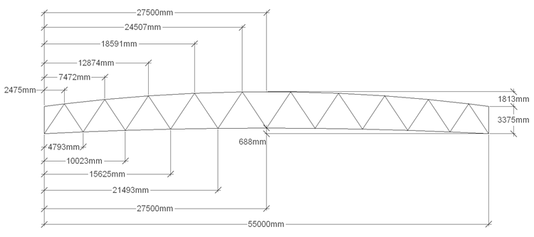

This model is of a 55m span steel truss footbridge, curved in elevation, constructed with square hollow sections for the bottom boom members and circular hollow sections for the top boom and bracing. The deck spans between the two bottom boom members and is braced diagonally with angles.
Footbridge
Footbridge Elevation Dimensions

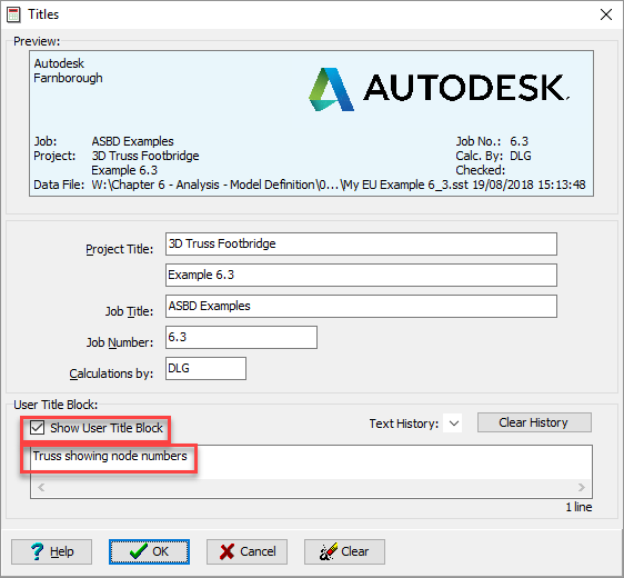

  2. Using the File | Titles menu option set the Project title to “3D Truss Footbridge” with a sub title of “Example 6.3”.
  3. Also set the Job Number: to “6.3” and put your initials in the Calculations by: field.
  4. Close the form with ✓ OK.

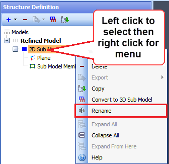

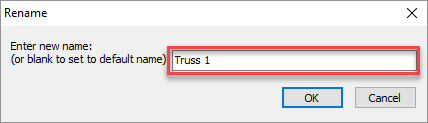

  2. Rename the sub-model to “Truss 1” by clicking on it in the navigation window first with the left mouse button then with the right and choosing the Rename option which allows text to be entered in the Enter new name: field.
    Rename Sub Model
    Rename Sub Model

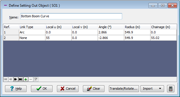

  3. With the new sub model highlighted add a Setting Out Object by using the add button and selecting the appropriate option.

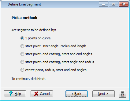

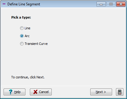

  4. Click on the small + at the bottom of the Define Setting Out Object form to add a line segment. Choose Arc from the Pick a type: options and click on the Next > button.
    Define Line Segment

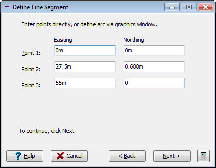

  5. The method we will choose to define the curve of the bottom boom is 3 points on curve – click on the Next > button.
    Define Line Segment
  6. Enter the three coordinates as (0.0, 0.0) (27.5, 0.688) (55.0, 0.0) and then click on the Next > button.
    Define Line Segment
  7. If the curve appears correct close the wizard with the ✓ OK button otherwise use the _< Back_ button to re-enter incorrect data.
  8. Change the Name: of the setting out object to “Bottom Boom Curve” before closing the form with the ✓ OK button.

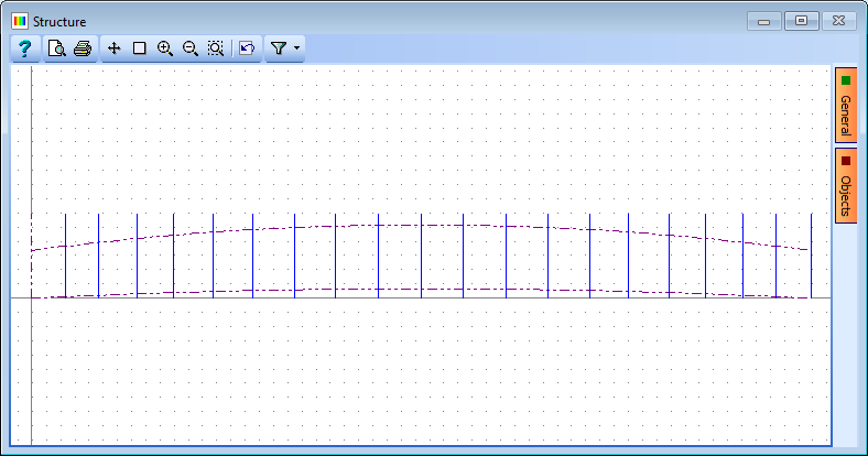

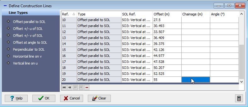

  12. Create a series of vertical lines that will intersect with the top and bottom booms offset parallel to SO3 with offsets as shown in the elevation drawing above (see the introduction to Part 6.3 of this manual).
  13. Use add and select Construction lines from the list. The first offset is at 2.475m. The bottom half of the table is shown below.
    Define Construction Lines
  14. There are 20 lines in total. The lines are added by selecting the Line Type +Offset parallel to SOL on the left of the form.
  15. Select “S03” in the SOL Ref. and enter the offset accordingly. Once all lines have been created close the form with the ✓ OK button.
    Construction Lines
  16. We will now connect the intersection points of these lines to create the beam members of the truss. This is done by opening the Define Sub Model Members form by clicking on the Sub Model Members item in the navigation tree.
  17. Select the draw mode in the graphics toolbar to multiple members Multiple Members and then set the snap mode to “Intersection”. Now draw the first member of the bottom boom by clicking close to the first intersection point from the left then the third point.
  18. The remaining members of the bottom boom can be created by continuing the clicking on intersection points five, seven ...etc until the last point is clicked then the “Esc” key on the keyboard will stop the selection. Any members drawn incorrectly can be deleted, by highlighting them in the table and clicking on the small - button at the bottom of the table, and then drawn again correctly.
  19. This can be repeated for the top boom except the intersection numbers will be 1, 2, 4, 6, 8, 10, 11, 12, 14, 16, 18, 20, 21 (note how the centre member is split in two to give a node at the apex).
  20. Draw the two end vertical members using the single member draw mode toolbar icon Single Member Draw Mode by clicking on the bottom intersection then the top.
  21. The diagonal bracing can now be drawn as multiple members, zigzagging from bottom to top across the truss.
  22. The members of the truss can be seen more clearly in the graphics if the construction lines and Setting out objects are turned off using the Objects button on the right of the graphics screen.

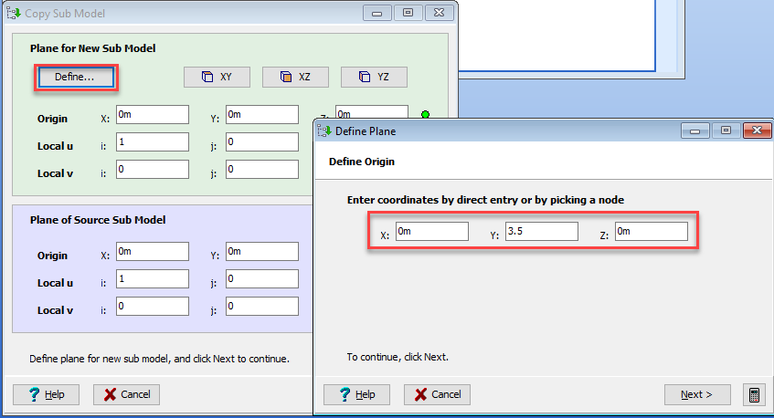

  24. Copy this complete sub-model to the second side and rename the second sub model “Truss 2”. This is done by right clicking on the first sub model entry in the navigation window and selecting the Copy option.
  25. In the Copy Sub Model form click on the Define button to define a new origin and plane for the copied sub model.
    Copy Sub Model
  26. Set the origin to (0.0, 3.5, 0.0) then click on the Next > button.
  27. The orientation of the plane does not need changing for the new sub-model so click on “Next” on the next two forms then ✓ OK to confirm.
  28. To actually create the new set of members click on the Next > button on the Copy Sub Model form and then ✓ OK to confirm.
  29. Rename this new Sub model to “Truss 2” in the same way as the first.

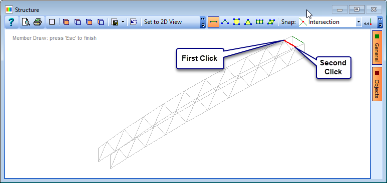

  31. Add a new 3D sub-model and in the graphics screen set the Draw Mode to single member Single Member Draw Mode.
  32. Draw the top boom transverse connecting members one by one by clicking on the node points in the graphics screen. The structure may need rotating into a suitable orientation to achieve this. Panning and zooming options in the toolbar may also benefit node selection.
    Draw Mode
  33. Add the top diagonal bracing in the same way but use the multiple beam members option Multiple Members, finishing with the “Esc” key when the last member has been drawn.
  34. Close the Define Sub Model Members form with the ✓ OK button.

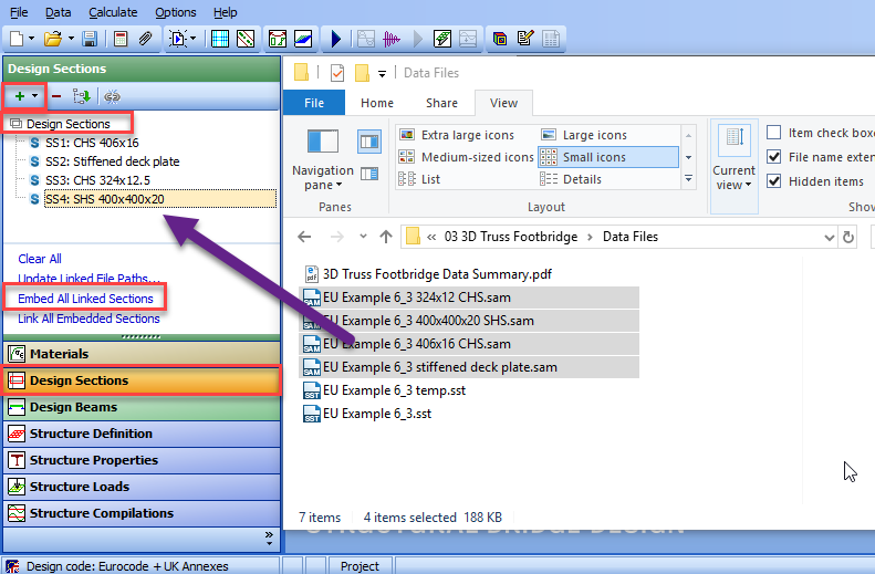

  1. Change the navigation window to Design Sections.
    The sections for all but the deck bracing have already been created in section files, so these can be imported. The deck bracing is defined by a parametric shape.
  2. Open up a standard file browser (outside of ASBD) and navigate to where the section data files are located. There should be four section files, namely:
    • EU Example 6_3 324x12 CHS.sam
    • EU Example 6_3 400x400x20 SHS.sam
    • EU Example 6_3 406x16 CHS.sam
    • EU Example 6_3 Stiffened Deck Plate.sam
  3. Select all these files together (using the Ctrl key whilst clicking on them) and drag them using the left mouse button into the white space of the Design Sections navigation window.
    Navigation
  4. The data from these linked files can be embedded into the project by clicking on the navigation window task of Embed All Linked Sections. The navigation tree can be tidied up by right mouse clicking in the navigation window and selecting “Collapse All.”

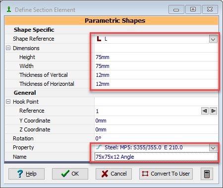

  5. The last section to be defined is an “L” parametric shape for the deck bracing. Click on the add button at the top of the navigation window and select the Parametric Shape option from the list.
  6. In the Define Section Element form set Shape Reference to “L”, height: and width: to “75mm”, thickness of horizontal and thickness of vertical to “12mm”.
  7. Also change the Name to “75x75x12 Angle” and Property to the S355/355 structural steel before using ✓ OK to close the window.
  8. Rename this new section (using the right mouse button context menu) to “Deck Plate Bracing."

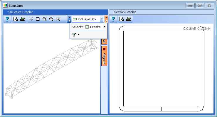

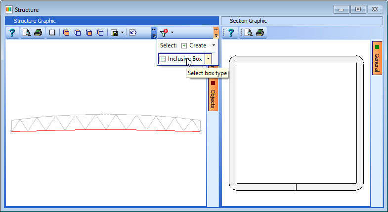

  10. Click on the 400x400x20 SHS item in the navigation window to open the data form Structure Properties: Section. This section needs to be assigned to the bottom boom members of the two trusses.
    This could be done by clicking on each bottom boom member individually in the graphics window but we will use filtering and orientation to make this a little simpler.

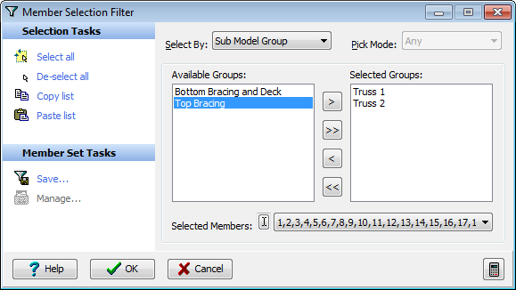

  11. To filter the structure to just the two trusses, click on the filter button in the graphics toolbar Filter. Because the toolbar is shortened due to the combined display with the section this may be hidden so the small triangle at the end of the toolbar must be clicked to display it.
    Trusses
  12. In the Member Selection Filter form click on the De-select all item in the Selection Tasks.
  13. Then change Select By: to “Sub Model Group."
  14. Double click on Truss 1 and Truss 2 to move them to the Selected Groups: as shown before closing the form with the ✓ OK button.
  15. Change the view of the structure, to view it from the South, by using the graphics toolbar button XZ Plane View.
  16. Window round the bottom boom members as shown to assign this section to the selected members in both trusses (ensure that the graphics dropdown is set to “Inclusive Box”).

  17. Close the data form for this section with the ✓ OK button then open the Section Data form for 406x16 CHS. This can be assigned to the top boom members in the same way as 49 above.
  18. To assign the properties for the other beams we first remove the filter by clicking on the small arrow next to the filter icon and choosing “Select All” from the list.

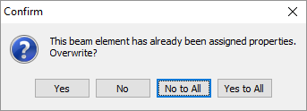

  19. Open the Section Data form for the section 324x12 CHS. Change “Inclusive Box” to “Exclusive box” in the graphics toolbar and then window round the top boom of the structure. This is in effect a crossing box (dotted) that will select all members wholly within the box and any member that is crossed by it.
    Exclusive Box
  20. It will try to overwrite the top boom members already defined but a confirmation box allow this not to happen by selecting the No to All button.
    No To All
  21. It may appear in the graphics that the top boom members have been selected (turned red) but in fact it is the bracing which is shown. This can be confirmed by changing the view to an isometric view. Click on the ✓ OK button in the Structure Properties: Section form to close it.

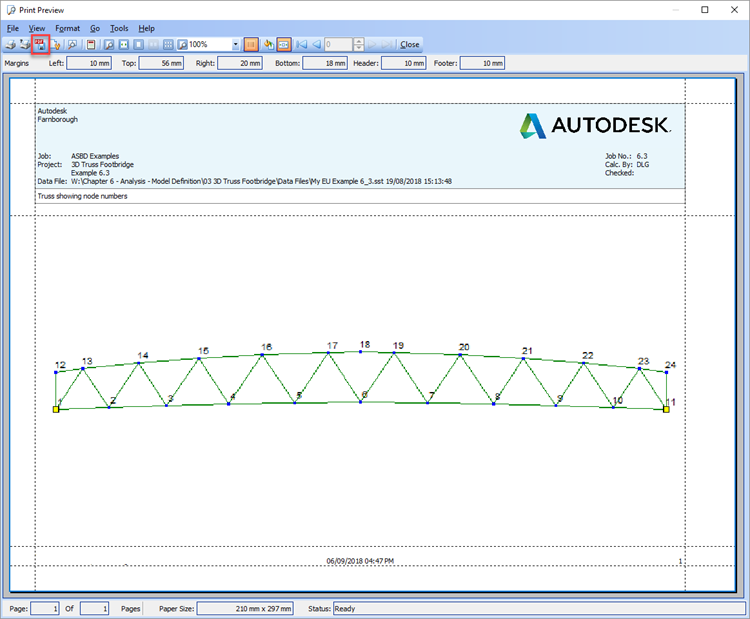

  1. The structure is now completely defined. It is required to produce two graphical reports to show the node numbering of Truss 1 and Truss 2.
  2. With all data forms closed and just the graphics window visible, filter the model to just “Truss 1”. This can be done by using the drop down selection displayed when the small arrow at the right of the filter button is clicked.
  3. Click on the General button on the right of the graphics window and tick the boxes for Annotate Joints, Show Nodes and Filtered Members Only. The display can be viewed as a “Print preview” before printing a hard copy. This is done by clicking on the print preview icon on the graphics toolbar. Also, a PDF of the graphic window can be generated by clicking on the PDF icon at the top of the print preview window.
    Print Preview
  4. You can see that there is nothing on the preview to say what part of the structure we are looking at. User titles can be added at this stage to highlight this. Click on the preview menu item Format | Titles and tick the box for Show User Title Block. A title of “Truss 1 showing node numbers” can then be added in the text field before closing the Titles form with the ✓ OK button. The new title can now be seen added to the graphics.
  5. Print a hard copy, if required, using the File | Print menu item then close the Print Preview window using File | Close.
  6. Repeat steps 76 to 78 with the filter and titles set for Truss 2.
  7. Remove the filter on the structure, switch off joint annotation, remove the user title block and set the viewing direction in the graphics to isometric.
