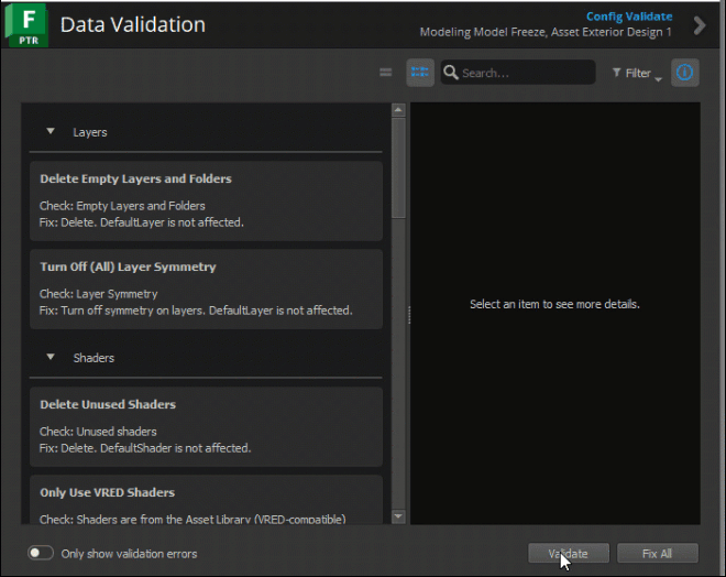

Access the Data Validation tool from the Flow Production Tracking menu in Alias (Flow Production Tracking > Data Validation).

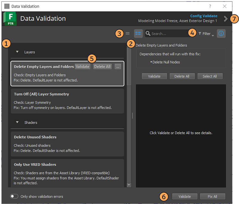

By default the Data Validation tool opens in Group View mode displaying the validation check descriptions in the left panel, and the Details Panel open on the right.
- Displays validation check descriptions and results.
- Details Panel: Displays information about the validation checks. Toggle the Details Panel display on and off by clicking this icon .
- View modes: Choose between the following View modes.
  • Group View ()- Displays the validation check descriptions and results grouped by data type: Layers, Shaders, and Modeling.
  • Compact List View () - Displays the name of the validate checks in a list. Roll over each item to display validation check descriptions and results.
- Filter: Provides options for filtering check description and results by data type.
- Validate by single check: Runs a validation check on the selected criteria. Fix invalid data for the criteria by selecting the appropriate option from Delete All, Turn Off All, Reset All, and Expand All. These options also appear in the Details Panel when a validation check item is selected.
- Validate and Fix All: Runs a validation check for all criteria. Fix All resolves all invalid data.
- Displays configuration details for the tool.
Validate your data
  1. Access Data Validation tool by selecting Flow Production Tracking > Data Validation. The Data Validation tool opens.
  2. To run a validation checks on all items, click Validate.
    The tool returns the results of the validation checks:
    • Items displaying green checkmarks indicate valid data.
    • Items displaying red caution icons indicate invalid data.
  3. Investigate the validation check results by doing the following:
    • Turn on Only show validation errors to display only the items with invalid data.
    • Select each item to display information about the validation check in the Details Panel.
    • To resolve all data validation issues, click Fix All.
    Note:
    You can also choose to resolve or investigate issues individually by selecting them (see step 4).
  4. To investigate issues individually, you can do the following:
    • Click this icon and choose Select All to pick the affected objects in Alias.
    • For additional information, click Affected Objects in the Details pane.
    • Click the item's fix option, such as Turn Off All, to resolve the issue.
  5. (Optional) Click Revalidate to rerun validation checks on resolved issues.
