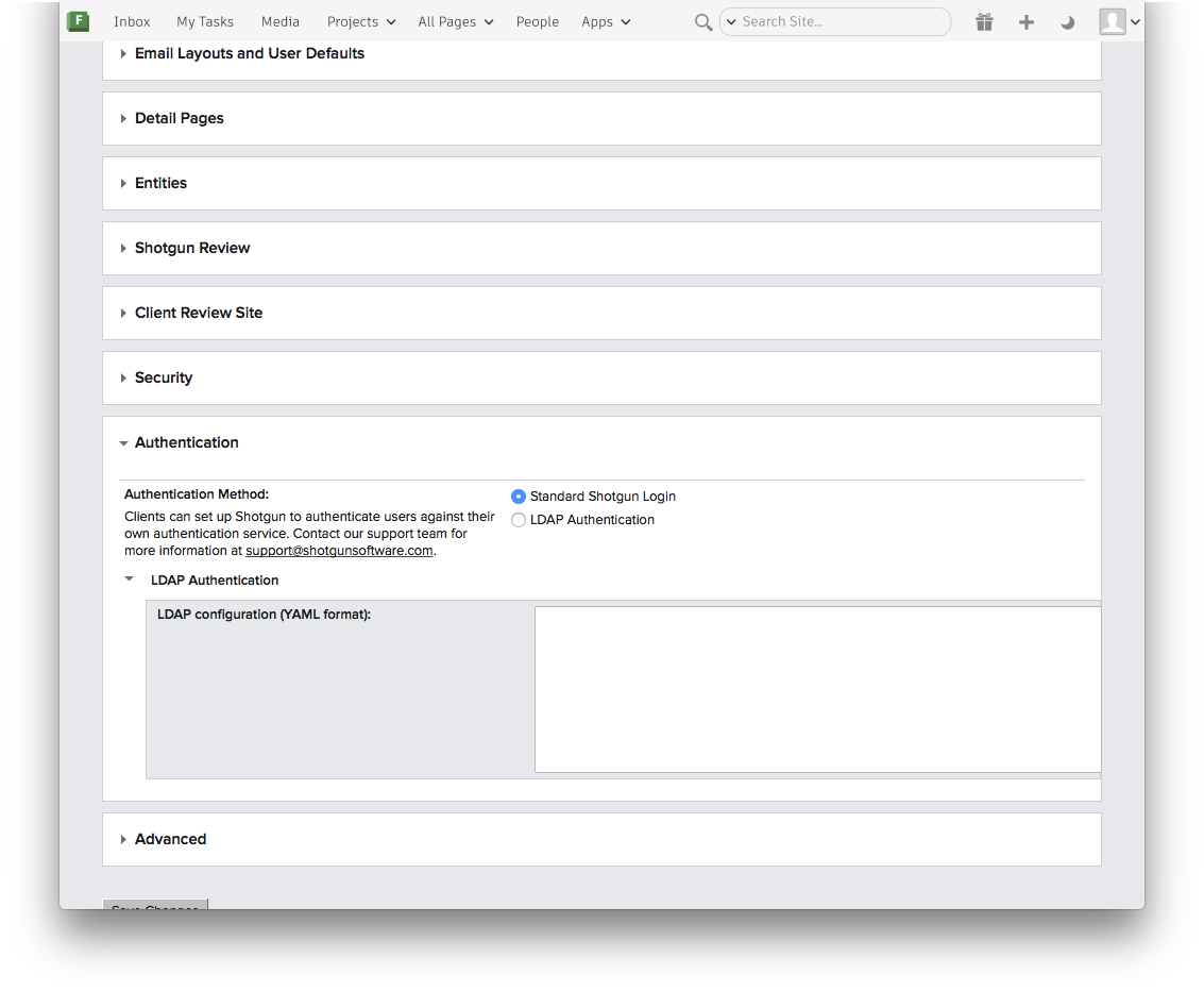

Under "Site Preferences > Authentication" select LDAP Authentication and copy the appropriate values based on the Acquiring LDAP Attribute Information step.
An example of YAML format configuration for “Fictitious Company” would look as follows (the following can be out-dated, make sure you use a copy of the ldap configuration, as explained above):
:auth:
:method: :simple
:username: 'cn=Shotgun_Net_LDAP,cn=users,cn=fictitious-company,dc=co,dc=uk'
:password: 'thisismyinsecurepassword'
:host: ldap.fictitious-company.co.uk
:port: 389
:base: 'cn=users,dc=fictitious,dc=co,dc=uk'
:user_login_attribute: SAMAccountName
:user_firstname_attribute: givenname Saving the preference change will activate LDAP authentication in Flow Production Tracking.
