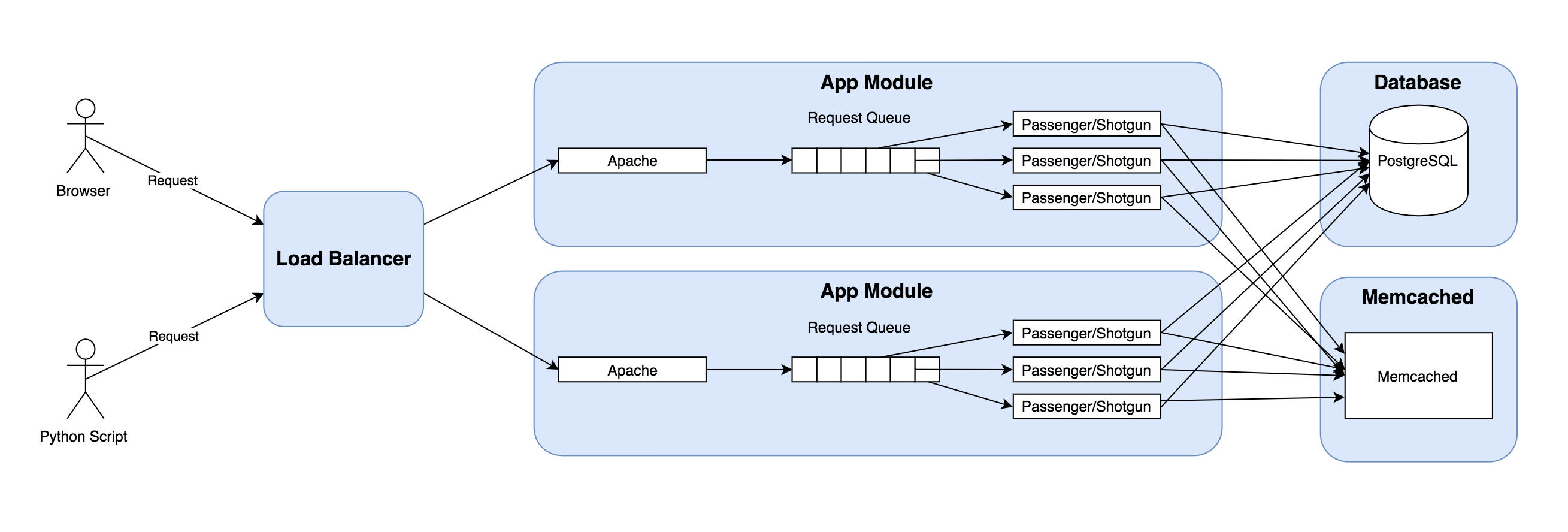

Flow Production Tracking application module
The Flow Production Tracking application module, or shotgun-app, is the component responsible of handling Web and API requests and responses. This layer can be scaled easily, allowing your Flow Production Tracking instance to handle more throughput.

com.flow production trackingsoftware.component: app A note on load balancing
Flow Production Tracking doesn't provide or recommend a product to load balance requests between your application containers. See Scaling Flow Production Tracking for more details how that can be achieved.
