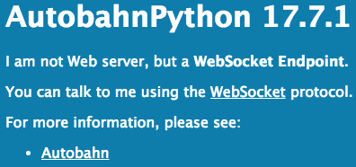

Launch Flow Production Tracking Desktop and then, in your browser, go to https://shotgunlocalhost.com:9000.
If everything is configured correctly, you should see the following in your browser:
