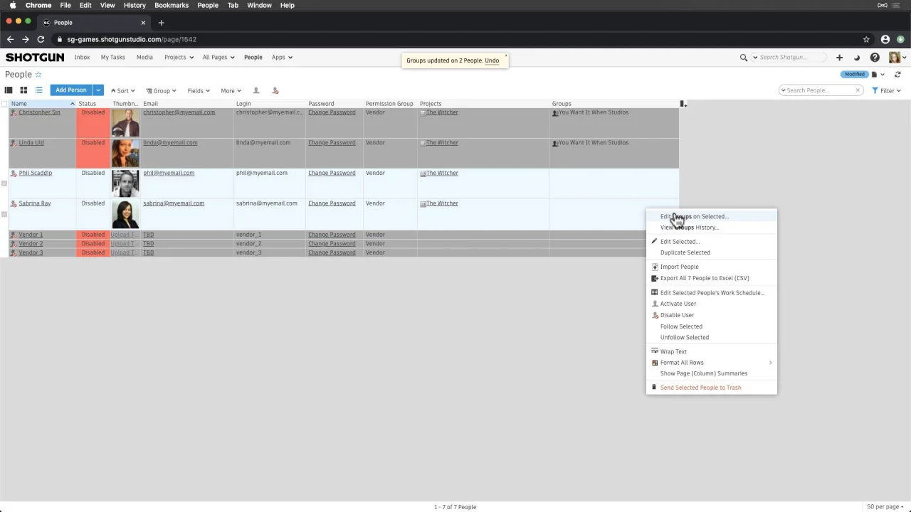

Adding Vendors to Flow Production Tracking

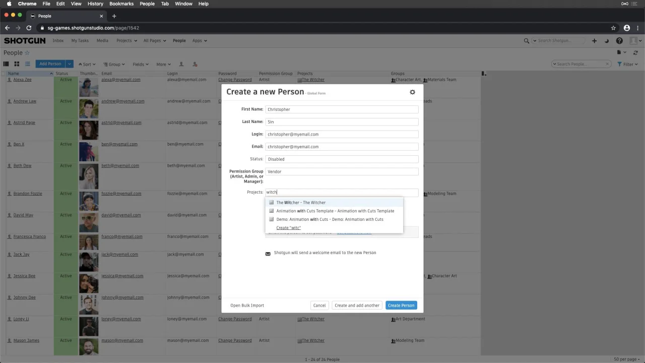

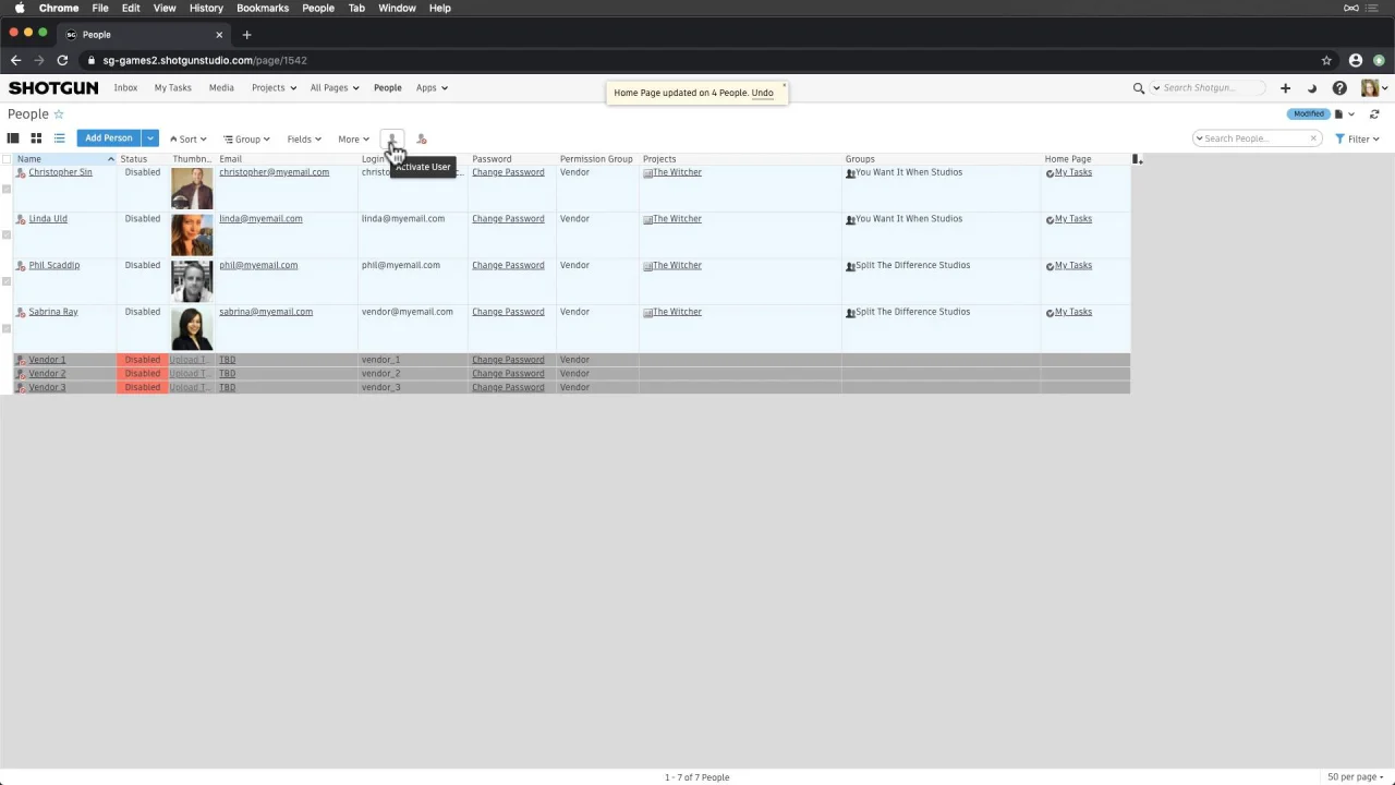

First, let’s create a couple of Vendors from our People page. Let’s deactivate their account upon creation, and send them a welcome email later on, once we establish our flow. Let’s also make sure that they are assigned the Vendor permission role, as this will restrict the information they can see when they log in. For instance, Vendors will only be able to see Tasks and Assets they are assigned to.
getting started

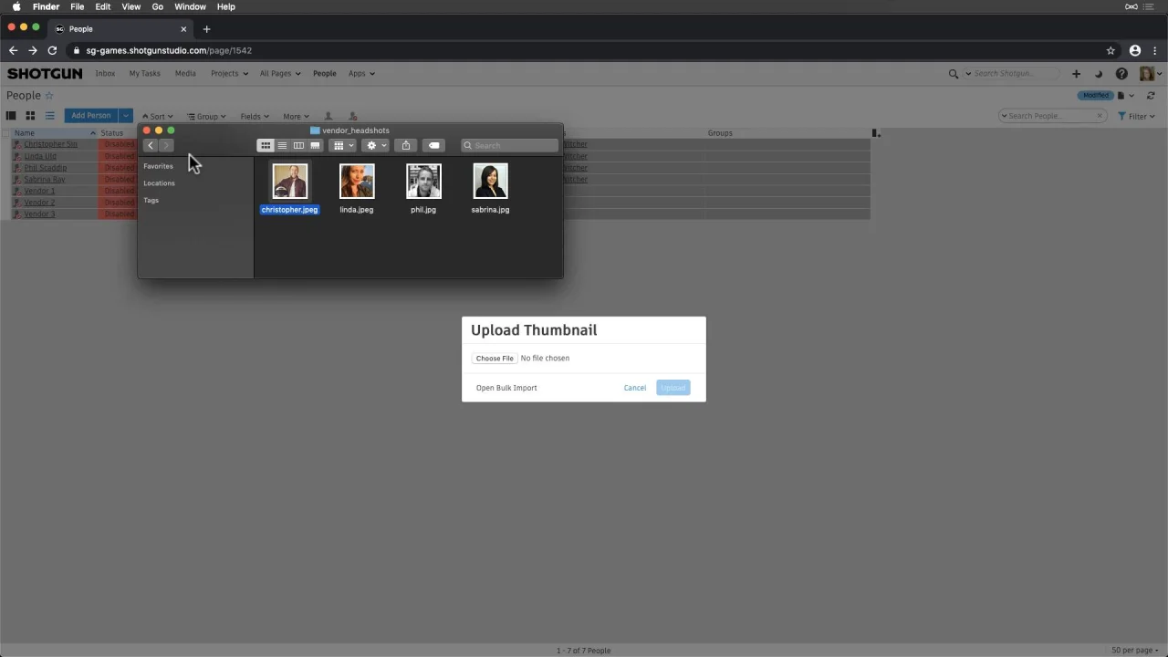

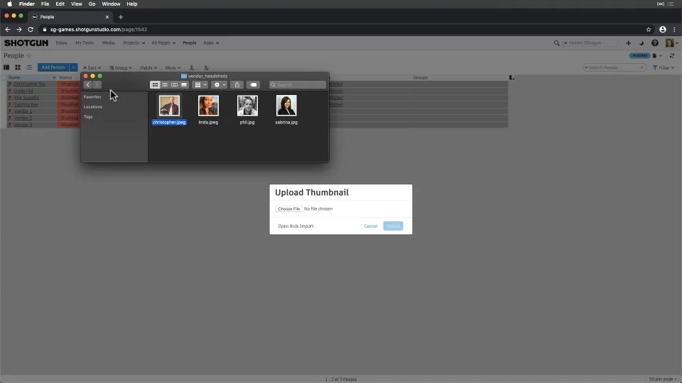

Since we created inactive users, let’s deactivate the default people filter so we see them. And we have their headshots, so let’s add them now.
getting started

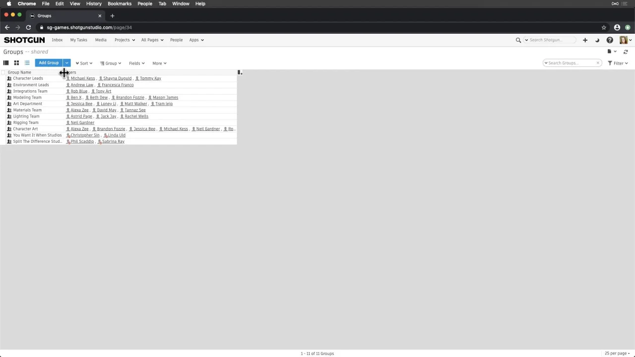

Organizing our Vendors with Groups
Christopher and Linda come from the same outsourcing studio, “You Want It When Studios”, so let’s add them to that group.
Phil and Sabrina are from another studio called “Split The Difference Studios”, so let’s add them to that group.
getting started
Groups are a great way to keep our people organized—whether we are organizing by vendor studio, department, lead teams, and more.

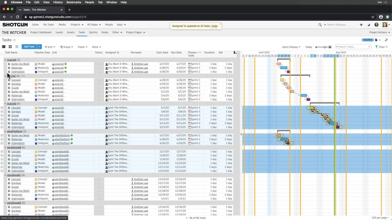

We can also assign Tasks to individuals and groups—handy when we’d like to assign a Vendor group rather than individual, and also handy when we need a group to review our work instead of one individual.
getting started
Organizing our Assets that are Outsourced

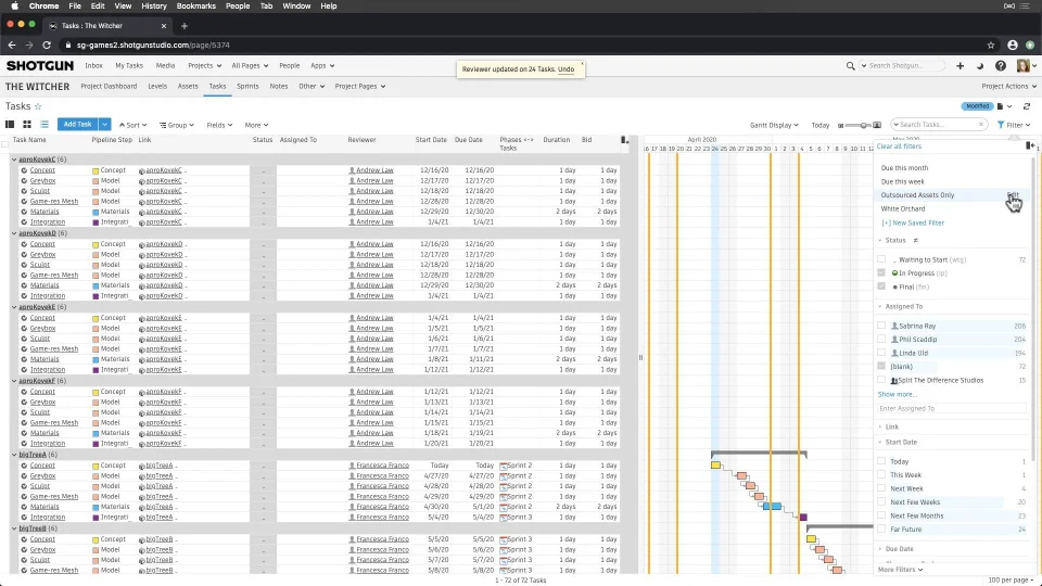

Previously, we identified which Assets we’d be outsourcing to our Vendors, and identified these Assets by checking the Outsource checkbox.
We can filter these Tasks to assign and schedule work being done by our Vendors.
getting started

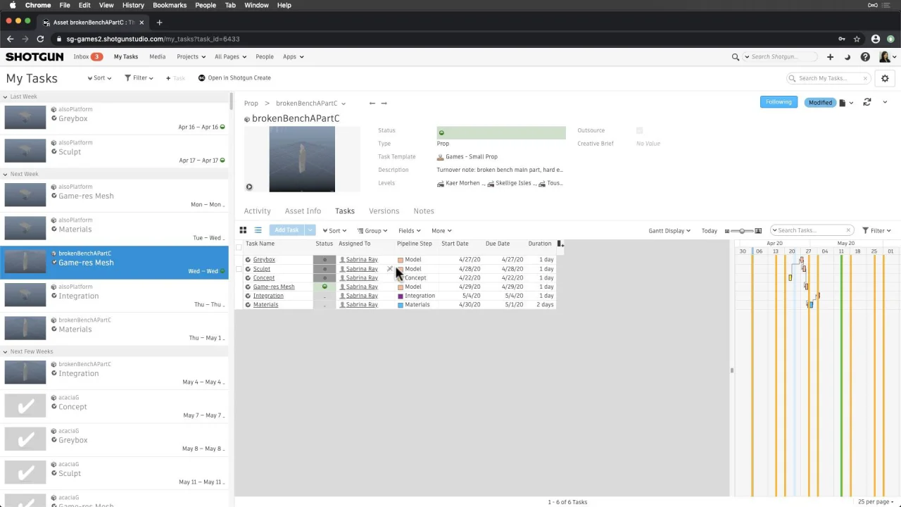

When Vendors log in, they’ll see their “My Tasks” page, with Tasks sorted in priority order: by due date. They can also see important information, like their schedule and key information on the Asset they’re building—like the description turnover notes and any notes addressed to them which they can reply to.
getting started

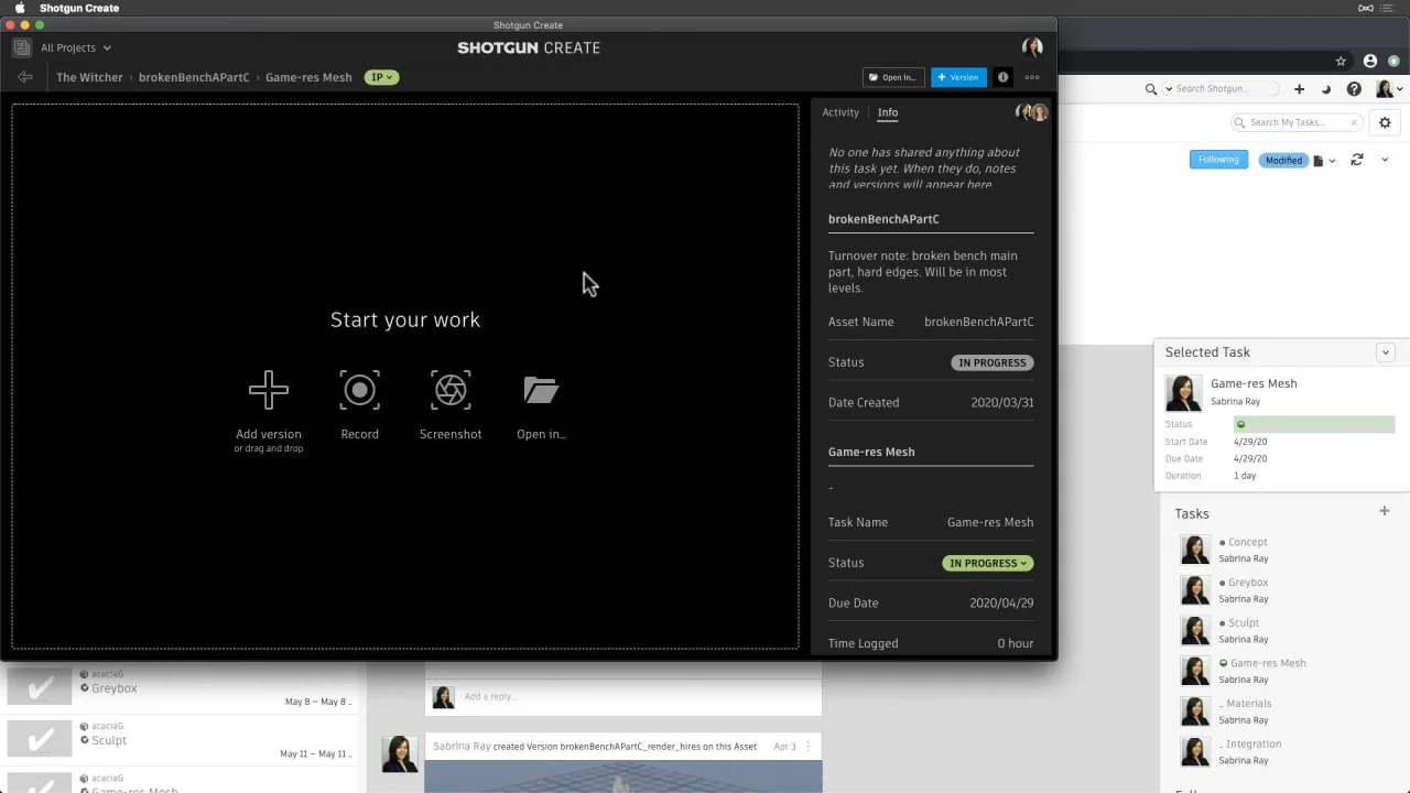

When they’re ready to start work, they can open Flow Production Tracking Create from My Tasks, see their Tasks and important information there, and get to work. When they’re ready to submit work, they can submit media with a description, and our Reviewers in-house will be notified to kick off the iteration cycle.
Note:
if Vendors haven’t downloaded Flow Production Tracking Create yet but open it from My Tasks, they’ll be greeted with instructions on how to download and get started.

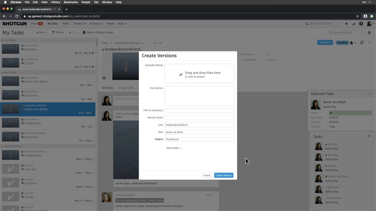

Flow Production Tracking Create simplifies the review workflow for Vendors, so ideally they work in Create, but if Vendors prefer to stay in the browser, they can also submit media directly from My Tasks in the browser. They’ll just want to make sure they’re on the Activity tab to see the selected Task box.
getting started

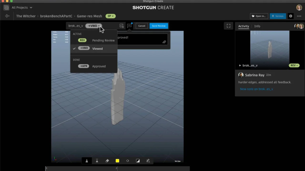

Here, we see Francesca, our Art lead, in her My Reviews area of Flow Production Tracking Create, reviewing the Version submitted by Sabrina, replying with feedback, and approving—changing the Version and Task statuses.
getting started

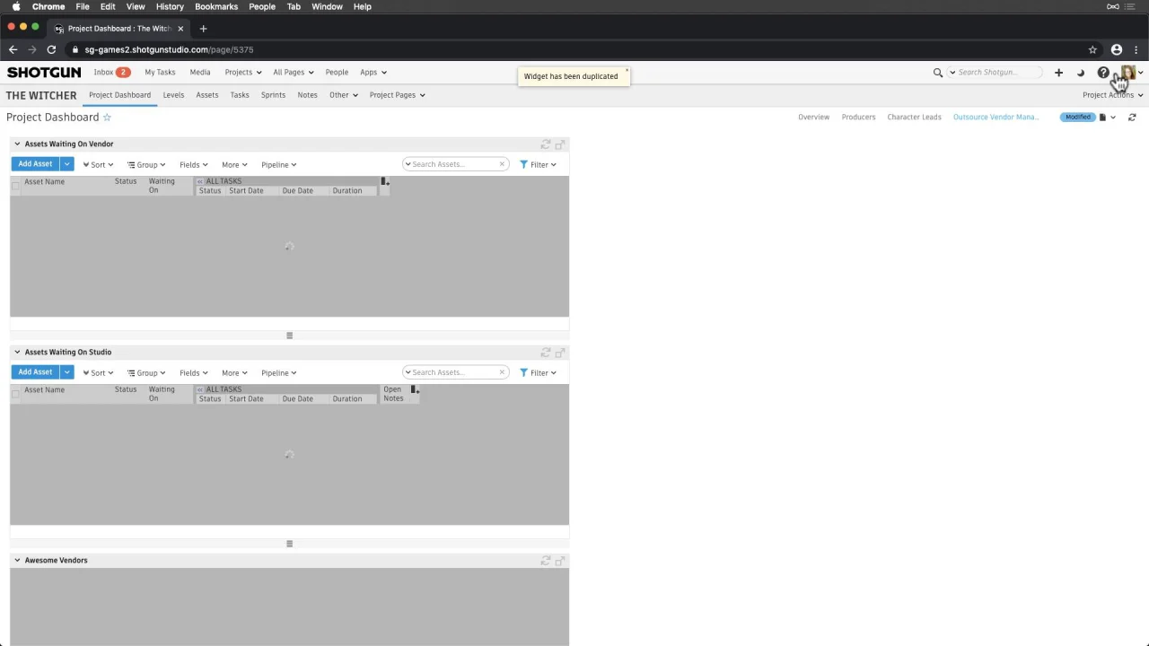

Creating a Vendor Manager Dashboard
Let’s pivot and think about how we can manage our vendors, and make sure that:
  1. They’re meeting our targets, and
  2. We’re setting them up for success so that they’re prepared for future work

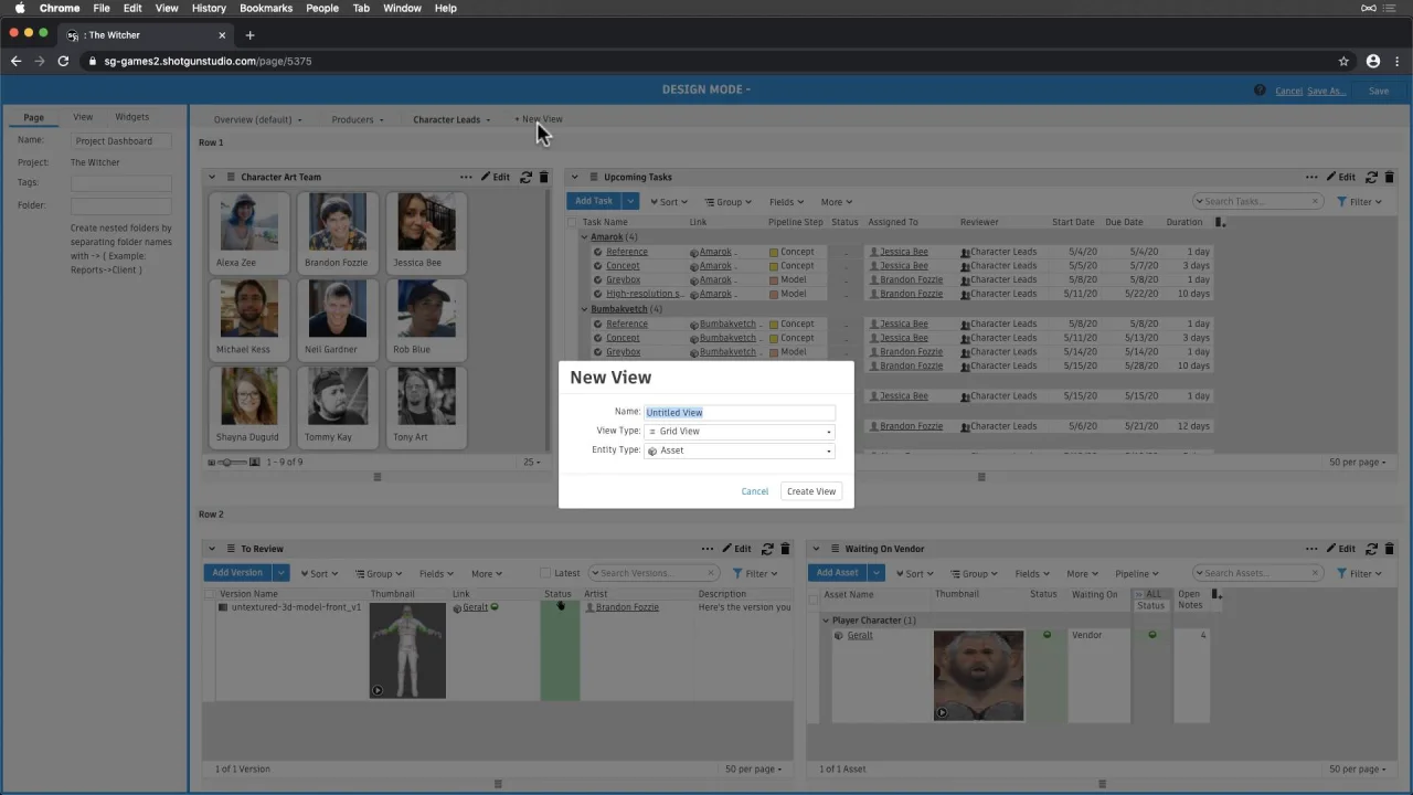

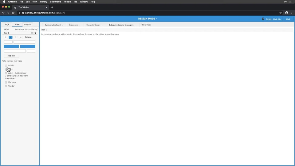

Let’s start on our Dashboard where we created our Producer and Lead views, and create a new canvas type view for Outsource Vendor Managers.
getting started
First, let’s make this view visible to Managers and Admins.
getting started

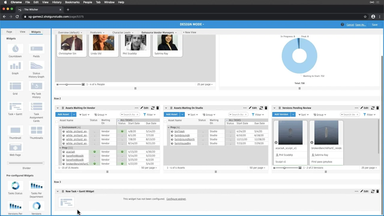

Before adding widgets, let’s outline what Vendor Managers need to visualize:
  • A list of Assets that they’re waiting on Vendors to submit
  • Assets Vendors are waiting on us for in order to move forward
  • Our team of Vendors
  • What’s happening in the review world
  • A summary of all Vendor task statuses for all outsourced assets
  • Outsourced Assets that have not been assigned yet

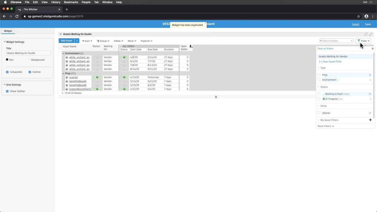

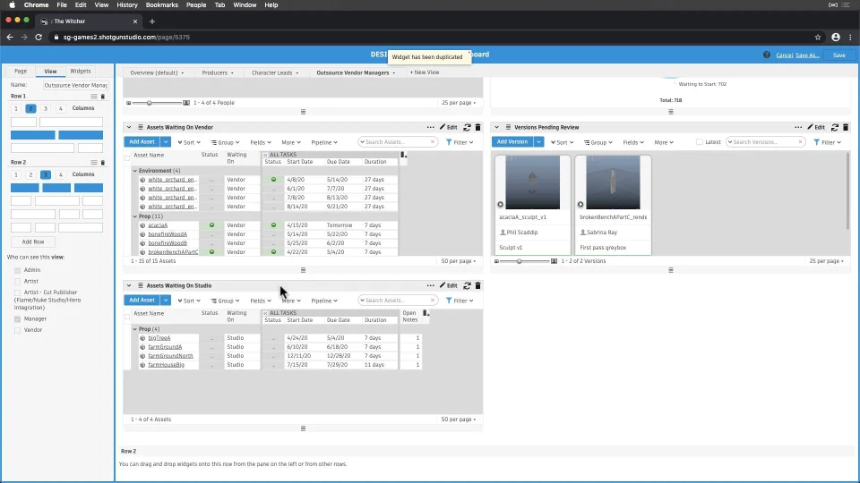

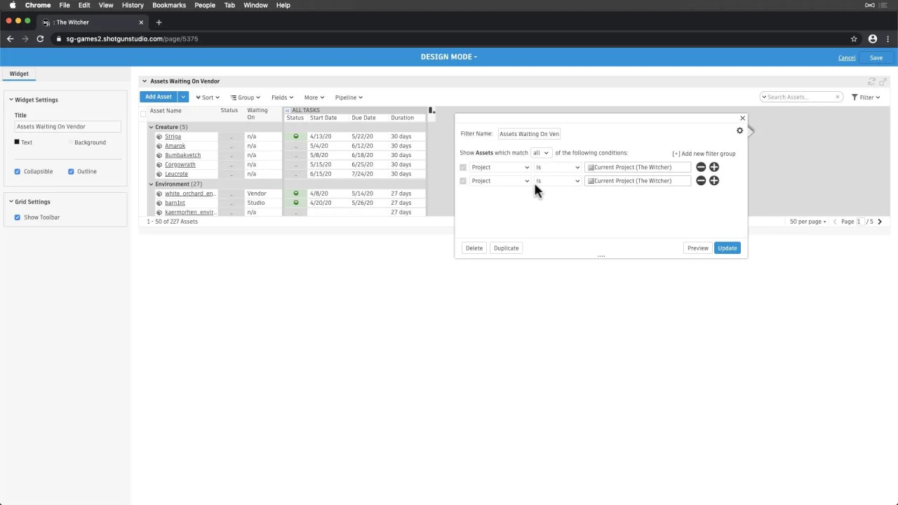

Assets Waiting on Vendors to Submit
For starters, let’s add the grid widget that will display Assets we’re waiting on Vendors to submit:
  1. Configure the widget to display Assets
  2. Name it “Assets Waiting on Vendor”
  3. Adjust the layout
  4. Add a page filter:
getting started
Now we have visibility on not only the Assets we need to follow-up on, but also the Task statuses in each Asset. We also saved and went back into design page mode.

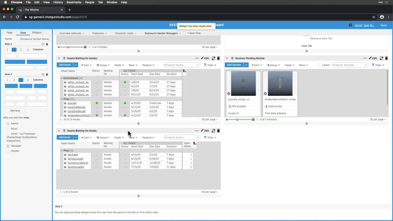

Just like the above widget, we want to create another one where our Vendors are waiting on us for something. So, let’s:
  1. Duplicate the “Assets Waiting on Vendor” widget
  2. Rename it to “Assets Waiting on Studio”
  3. Add the Open Notes Count field
  4. Adjust the filter so we’re seeing assets waiting on the studio:
  5. Save again
Now, we can see the list of assets Vendors are waiting on us for, and see any notes relating to why in the open notes column.
getting started

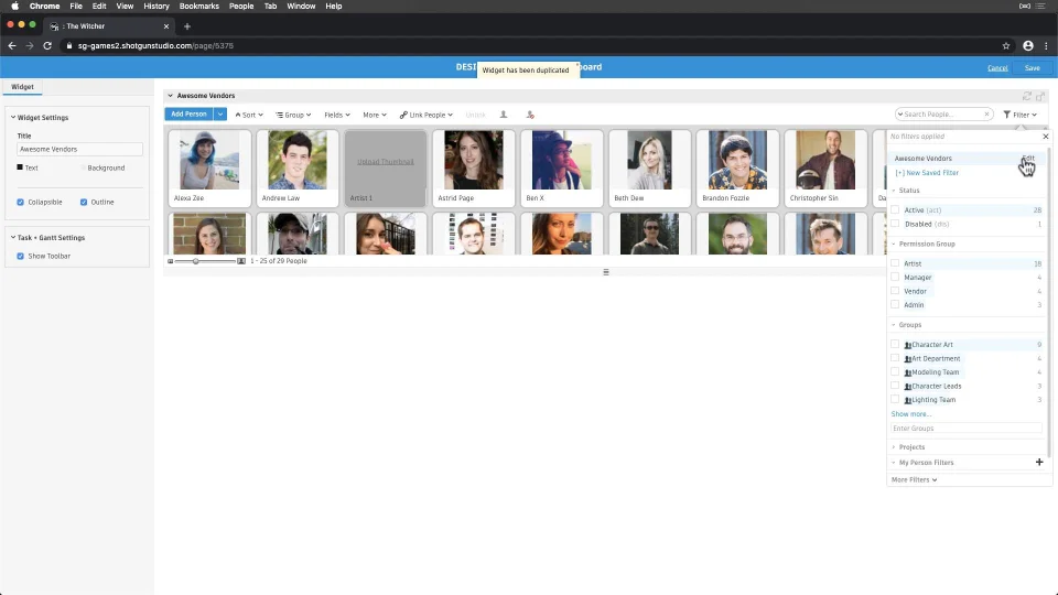

Next, let’s add a thumbnail widget to display our Vendors:
  1. Configure to display Person
  2. Filter our people by:
getting started
Then, adjust the widget settings to simplify by removing the toolbar.
getting started

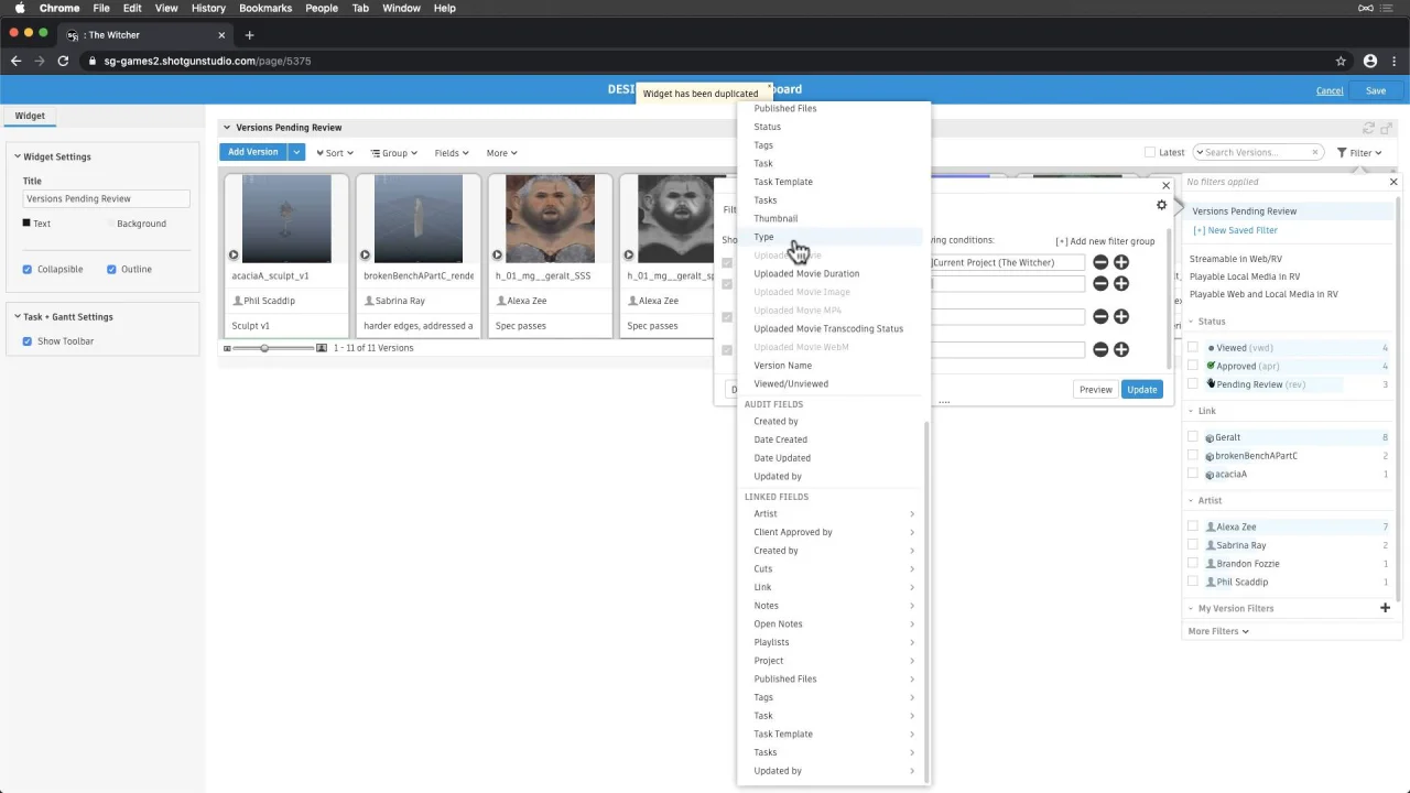

Now, let’s see what’s happening in the review world, and ensure things are churning. So, let’s add another thumbnail widget for Versions.
Let’s adjust the columns to show:
  • Artist, Description
  • Status
  • Version Name
  • Date created
getting started

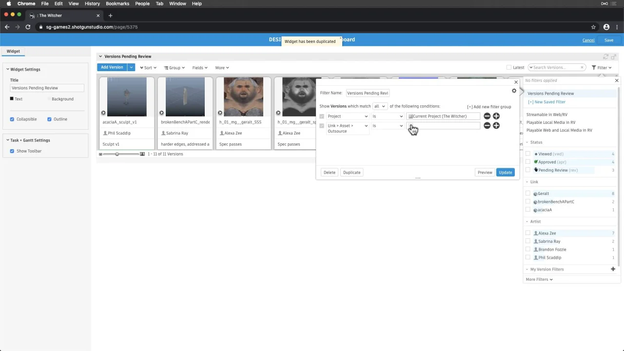

Currently, we’re seeing all versions in the project regardless of status, so let’s filter down this information to only vendor submitted versions pending review:
  1. Versions > Link > Asset > Outsource checkbox is checked
  2. Versions > Link > Asset > Status is not final
  3. Status is Pending Review
  4. Artist > Person > Groups includes “You Want It When Studios”, “Split The Difference Studios”

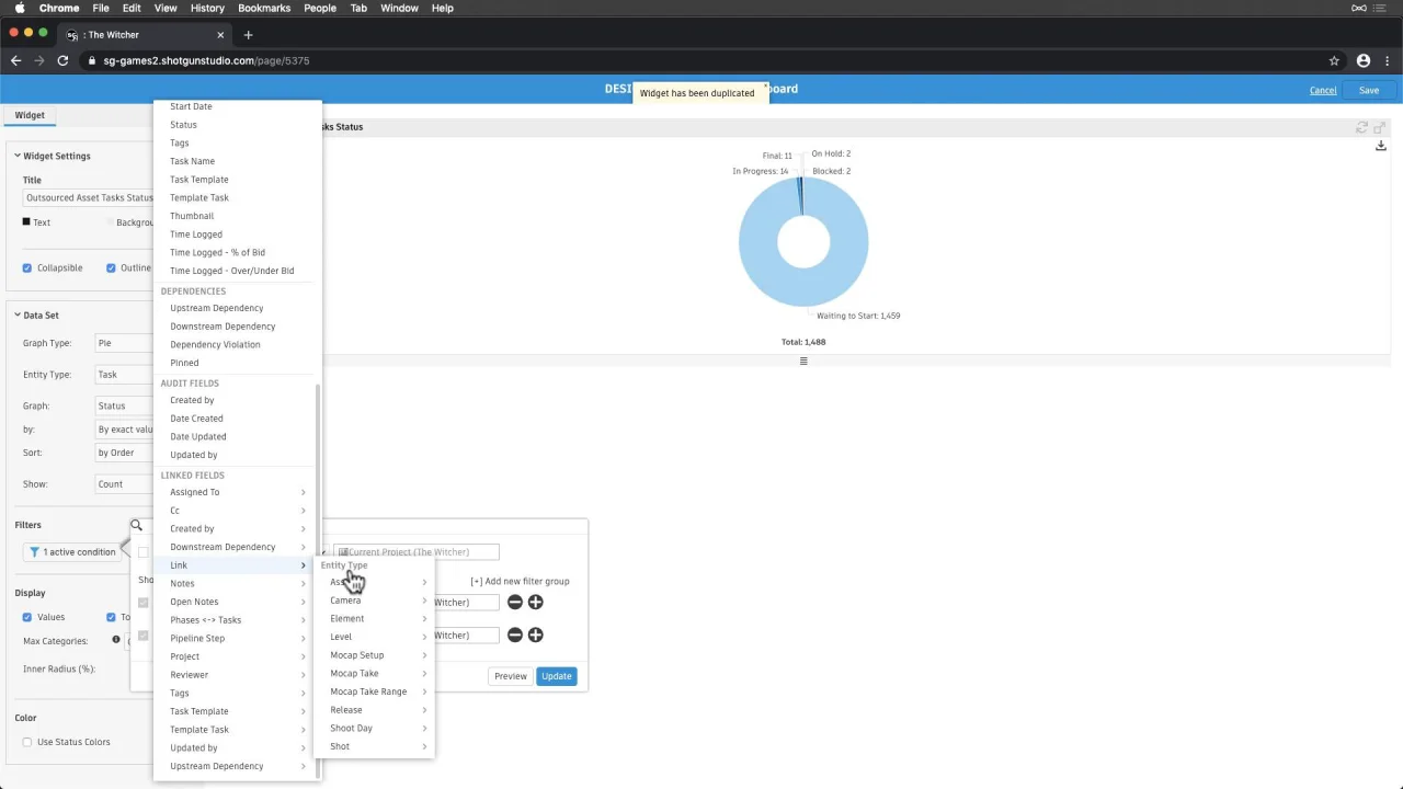

Summary of Vendor Task Statuses for Outsourced Assets
Let’s add a preconfigured Task Status widget, and add a condition that shows us the overall status of our outsourced Asset tasks.
getting started

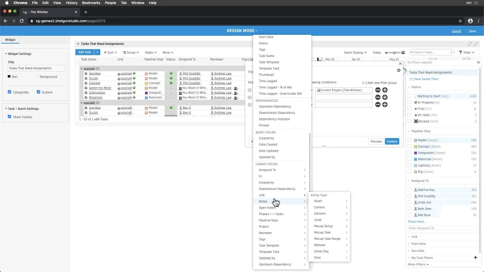

Outsourced Assets that Need Assignments

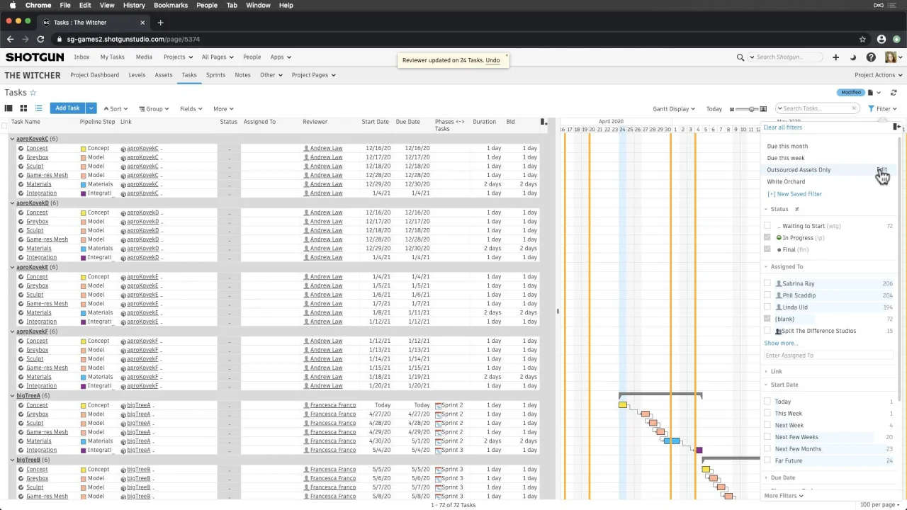

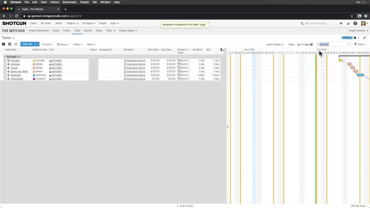

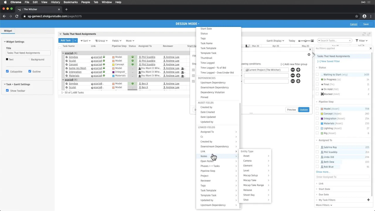

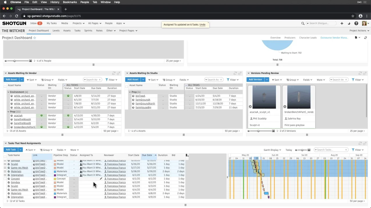

Lastly, since Vendor Managers need to visualize what needs to be assigned, in priority order, let’s create a new widget they can interact with from our dashboard. Let’s add a new row, and then let’s use the Task Gantt Widget.
getting started
Then, make the following adjustments:
  1. Name it “Tasks That Need Assignments”
  2. Adjust the layout
  3. Create a filter:
  4. Ungroup the records
  5. Apply an Advanced Sort
getting started
Now, our Vendor Managers can have a glance at Tasks that need to be assigned to Vendors, and in what order they need to be assigned. They can also assign directly from the widget.
getting started
This is a great foundation for our Outsource Managers to start managing Vendors from, and we can make adjustments and tune things further as production evolves.
