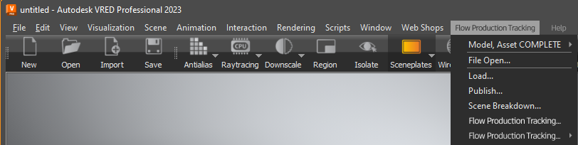

This Flow Production Tracking integration supports the VRED product family (Pro & Design). When VRED opens, a Flow Production Tracking menu (the VRED engine) is added to the menu bar with all the tools and options needed for working on your project.

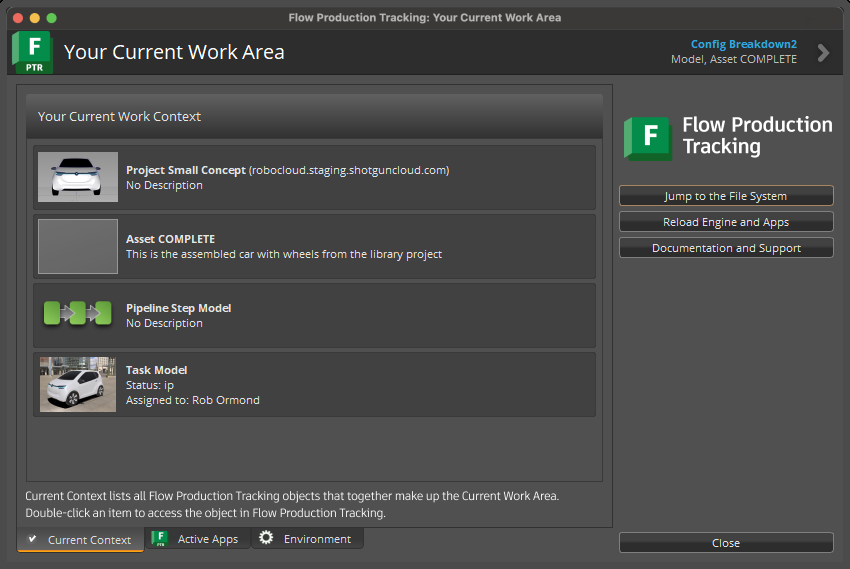

Work Area Info (technical tool)
Flow Production Tracking > [Project Name] > Work Area Info shows the current work context, a breakdown of all currently running apps, plus all settings and configurations for the currently running Flow Production Tracking Apps.
Your Current Wrok Area window
  • Click the tabs at the bottom to switch from one to the next.
  • Click the arrow at the top to expose more information on the Flow Production Tracking Pipeline Toolkit and your current work area. Use the buttons along the side to jump to the file system, reload the engine and apps, or access documentation and support.

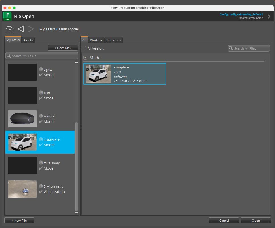

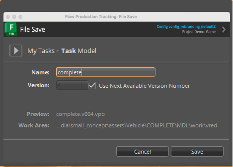

File Open and Save
Use the My Tasks and Assets tabs to see all your assigned tasks and browse for assets. To the right, use these tabs to view all files, working or published files associated with what is selected to the left.
The File Open dialog in VRED
The File Save dialog in VRED

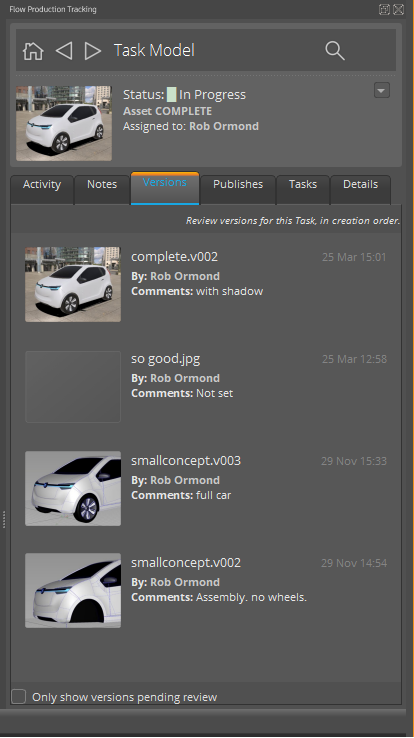

Flow Production Tracking Panel
Flow Production Tracking > Flow Production Tracking Panel toggles the display of the panel in VRED, which is a small and lightweight window for accessing all information stored in Flow Production Tracking related to your current project, without ever leaving the application you’re working in. Easily access task information, the activity stream, notes, tasks, versions, and published files from Flow Production Tracking. Review versions sent by teammates, reply to notes, create new tasks, and search the Flow Production Tracking site.
The panel appears next to the viewport, but can also be undocked.

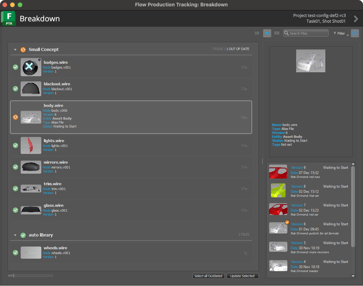

Scene Breakdown
Scene Breakdown: Opens the Breakdown dialog, which displays a list of “referenced” files (and their links), along with what in the scene is out-of-date. Select one or more items and click Update Selected to switch and use the latest version of the content.
The scene breakdown dialog for VRED
