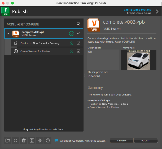

The Basic Config is the default Flow Production Tracking integrations. There is no setup required to use the Basic config. When you want to publish a file in VRED, select Flow Production Tracking > Publish from the VRED menu. In the Publish dialog, you can see two publish options, which are called publish plug-ins. These options are standard across all Flow Production Tracking integrations. Click an option for information.
Begin File Versioning
Adds a version number to the file name.
Publish to Flow Production Tracking
Creates a Published File in Flow Production Tracking with a reference to the file's current path and location on your system.
The Publish dialog

Publish Translations to Flow Production Tracking by selecting a translation format for creating a Published File. These translated files will be linked in Flow Production Tracking with the original VRED file. The translation uses the current VRED settings for the specified format.
The Publish dialog displaying a VRED Session scene file
